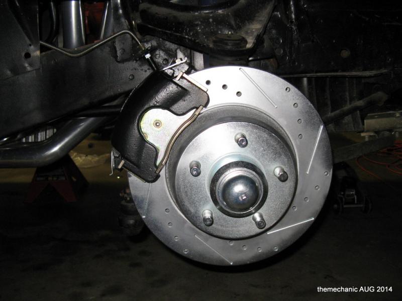

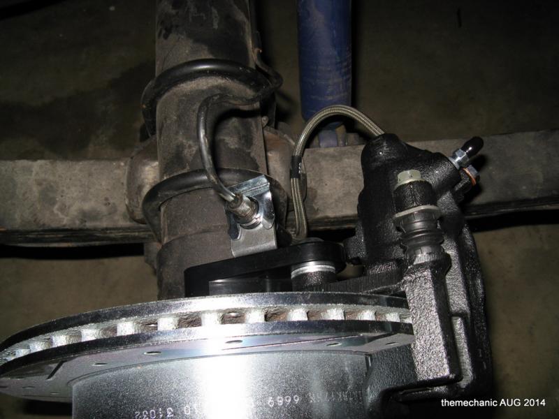

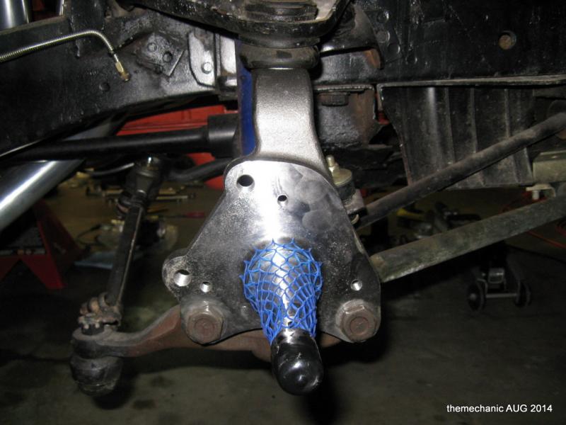

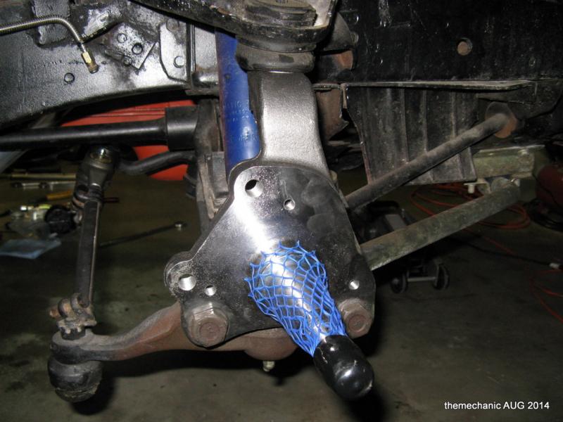

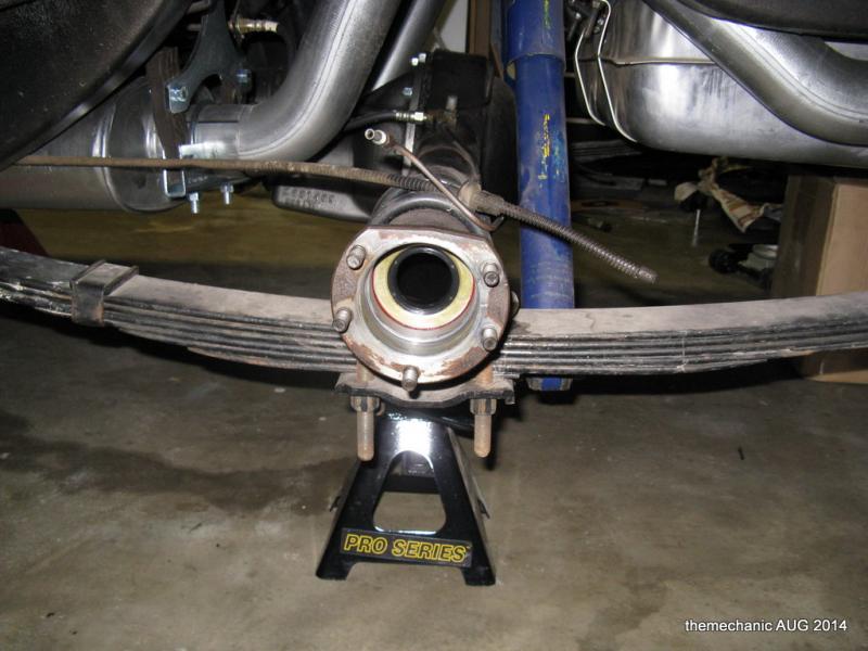

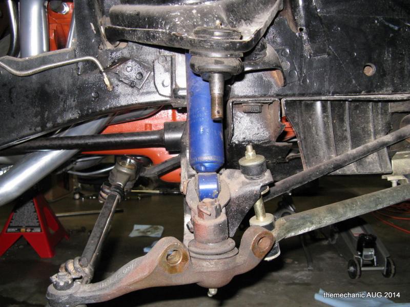

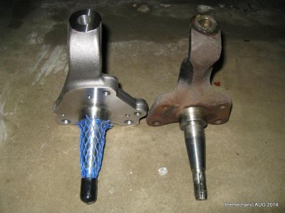

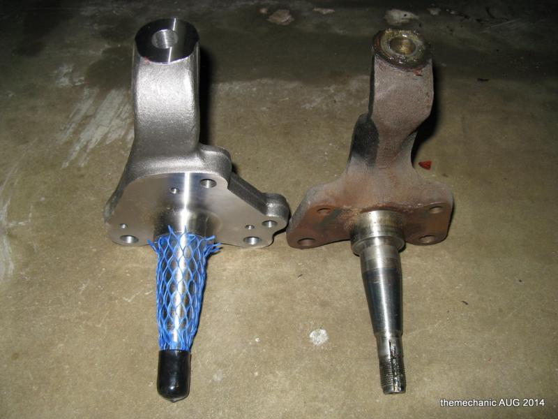

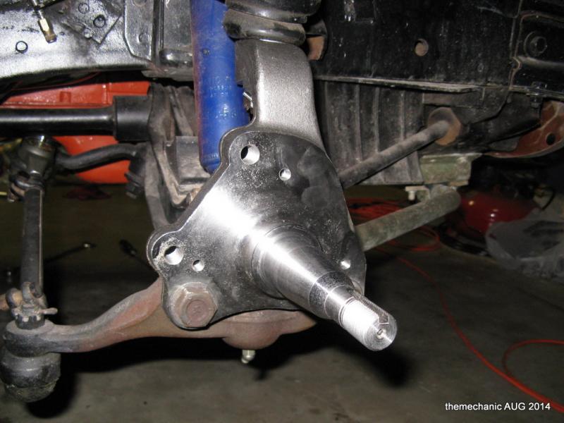

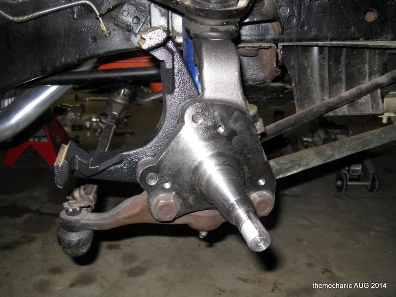

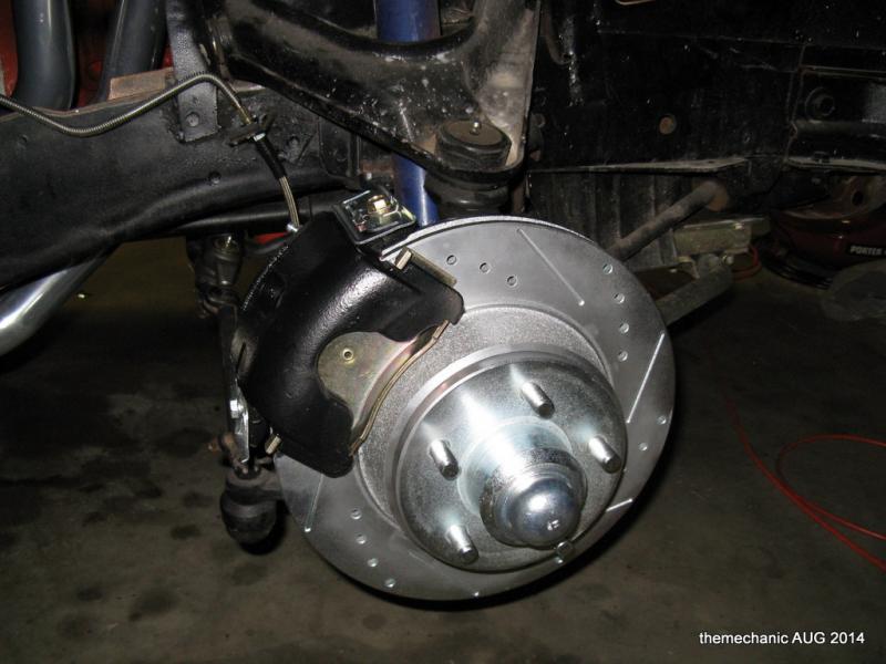

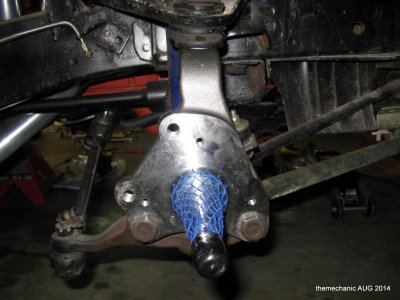

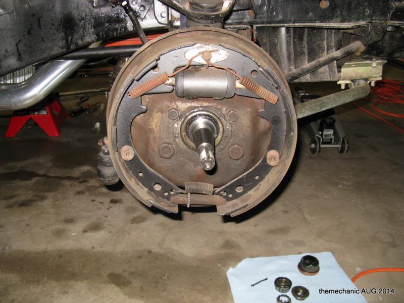

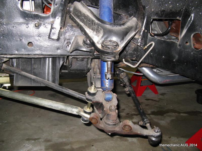

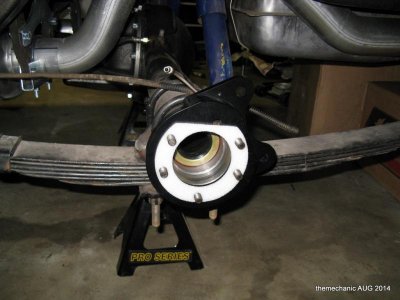

I ordered a front disc brake kit from Cass at Dr. Diff just last week, got the parts the other day. He uses The Right Stuff in his kits so it's comparable to what you're looking at. I like Dr. Diff because Cass picks up the phone every time; I just called him today with a question and he helped me out and then e-mailed me a link of someone who had taken pics of an install using his kit. I picked up the 11.75 kit so I can't specifically answer your question about the 14" rims. Another source is Wayne at The Ram Man - great website with videos. He's a little harder to get on the phone. Good luck!
I posted the photos from my installation but I doubt you would need them; it's pretty simple.

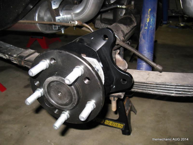

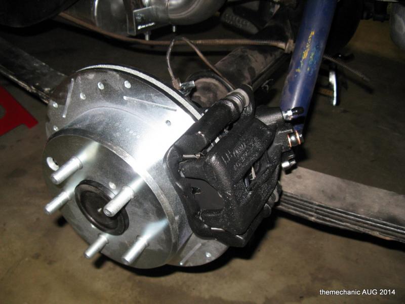

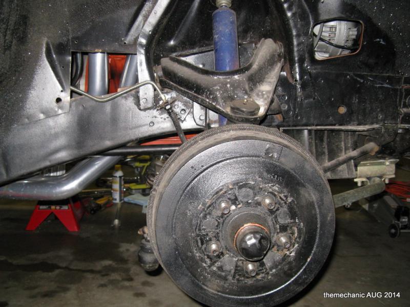

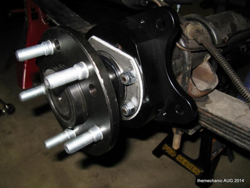

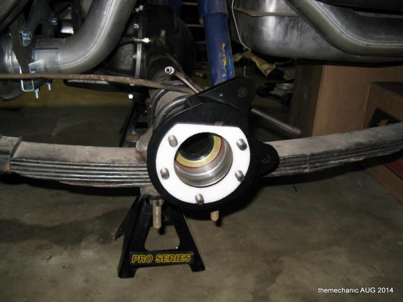

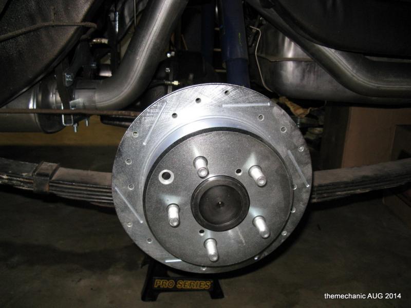

Well, I thought I had posted the photos but couldn't find the post. So, here you go for front and rear conversion. The link is to the Pirate Jack booster kit install.
http://www.forbbodiesonly.com/moparforum/showthread.php?69438-Pirate-Jack-s-Power-Disc-Brake-Booster-Kit&highlight=disc+brake
DoctorDiff Front Drum to Disc
IMG_0002.jpgIMG_0005.jpgIMG_0006.jpgIMG_0007.jpgIMG_0011.jpgIMG_0013.jpgIMG_0014.jpgIMG_0016.jpgIMG_0017.jpgIMG_0018.jpgIMG_0019.jpg
DoctorDiff Rear Drum to Disc
Rear drum to disc conversion.jpgRear drum to disc conversion-001.jpgRear drum to disc conversion-002.jpgRear drum to disc conversion-003.jpgRear drum to disc conversion-004.jpgRear drum to disc conversion-005.jpgRear drum to disc conversion-006.jpg
