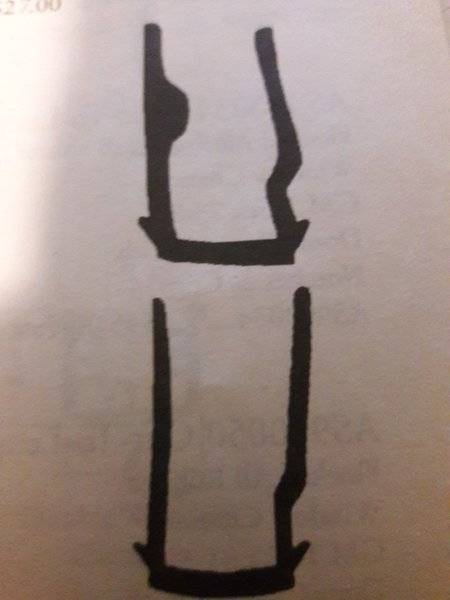

Located in the door cavity is a channel that locates the glass for the correct alignment. Based on the year model and body style, dictates which style of channel was used. The channel is lined with a heavy rubber extrusion that is flocked so as to assist in allowing the glass to go up and down smoothly. It also protects the stainless trim found on some of the glass from getting scratched. The original extrusion was held in place with two rivets per channel and a very light bead of glue. It was a formed extrusion which fits tightly to the channel.
The extrusion can be changed out with little effort. Most restorations do not go to this level and due to the location, some of them are in decent shape and do not need to be replaced. Depends greatly on what the door was exposed to over the years.
Not sure of the year model that you might be working with, but the 66/67 extrusion is no longer available. The 68 to 70 extrusion is available and there is different profiles based on being a hardtop, two door sedan or convertible. On a side note, the E-Body glass channel run is also available.
Hopes that this might help. I have attached a picture of the 68-70 B-Body Hardtop and Convertible profiles. The Sedan profile is approximately half the size of the the two pictured.
Thank you. that helps a lot. I believe my channels are in okay shape. The upper drivers door slides were missing and the bottom is there. There is also a clear thin sheath that hugs the SS trim that fastens to the glass edge and is as long as the glass is. I don't see that for sale either. The slides that I do have seem worn but I have no good ones with which to make a comparison. So, the 67 Coronet channel has grooves in it that the slides ride in which in turn keeps the door glass from tipping backwards, yes? And THAT channel is no longer available.
