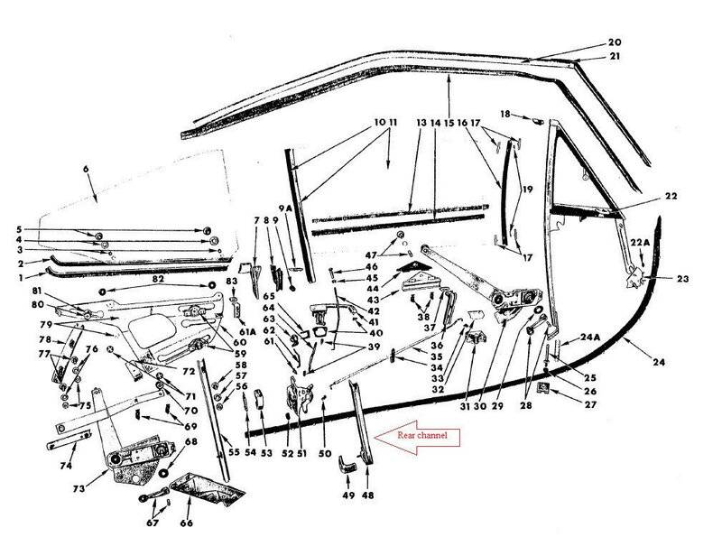

Hi,
Installing the rubber felt pieces (AS2001) into the window rear run channel on my '69 Charger, but it did not include rivets... can I use pop-rivets ? Was not sure if the window glass metal channel would interfere if I used them... thanks...

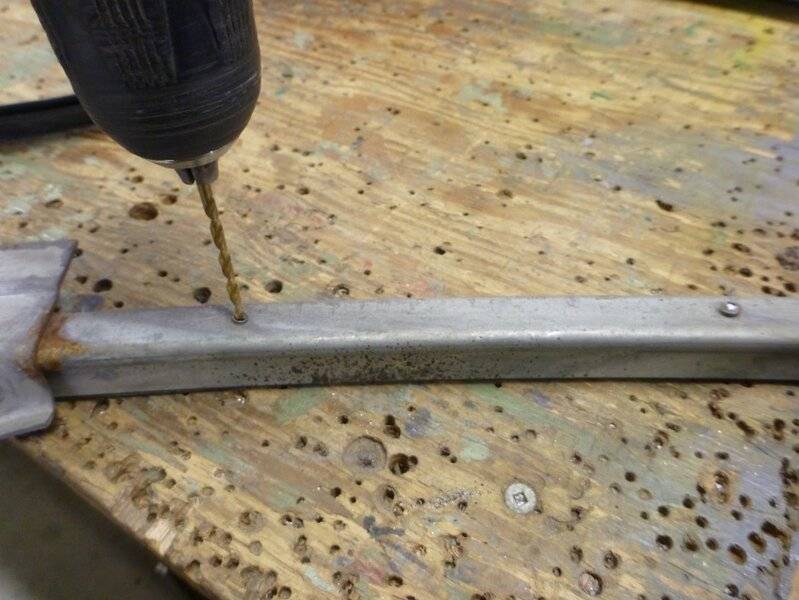

Drill out the originals.

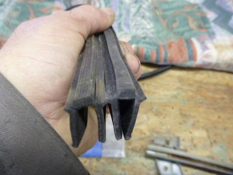

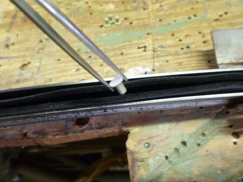

OE and reproduction seal

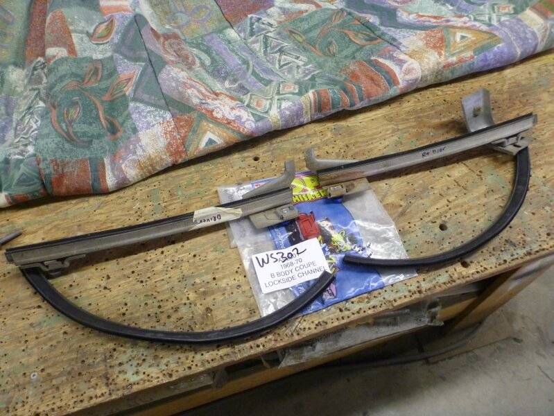

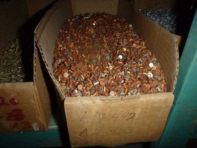

I have a few rivets around..

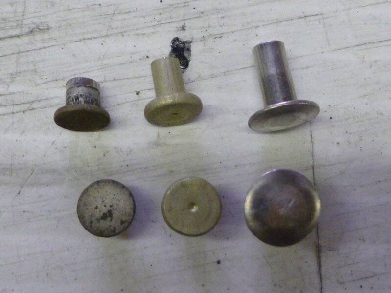

Original, aircraft rivet I used and the way oversize tubulars that came with my seals that I discarded.
New seals in place, uncut.

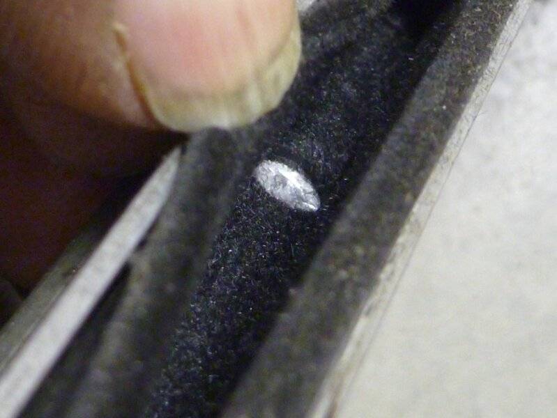

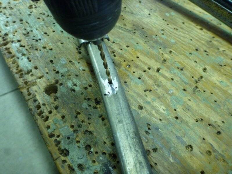

Drill new hole in new seal.

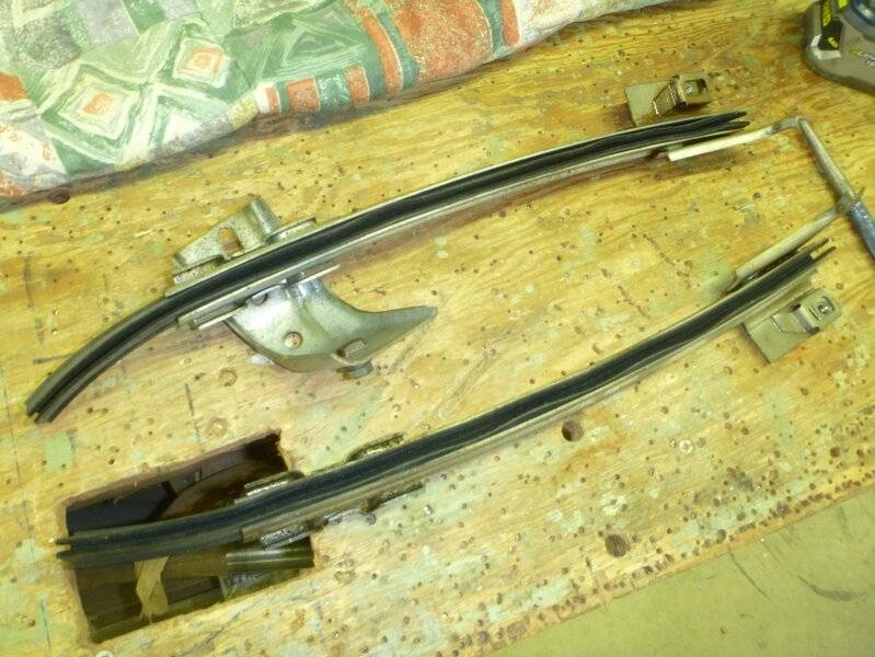

Insert new rivet.

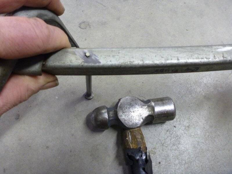

Rivet head backed up with an ejector pin/punch same diameter as head and shop head formed with hammer.
Done deal.
The "smash" rivets that came with my DMT rear channels worked really well.
As long as the fastener is buried well below the felt, anything will work.
Keeping it smooth is the name of the game.
Insert new rivet.
