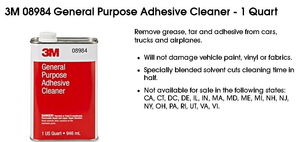

The 3M adhesive remover works ok, unless you have big globs of stuff, then just scrape with a razor blade, then use the remover. You can also use brake clean, that works also, but only if the glass is still out of the car as it can remove paint as well!
Thanks idrivemopar. The comments about "new" glass being wavy is what I've heard and was told by more than one glass companies and a vendor. Also, those companies said that their glass isn't as thick as the original. My side glass is just needing a good polish and there's no cracks on the front windshield nor the back glass. All of the glass is out of my car. My game plan was to use a razor blade to trim off the thick "tar like" butyl sealer off and go over it with some sort of substance that will make the rest come off easy, then use some kind of polish for the side glass like you stated.
