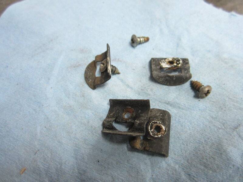

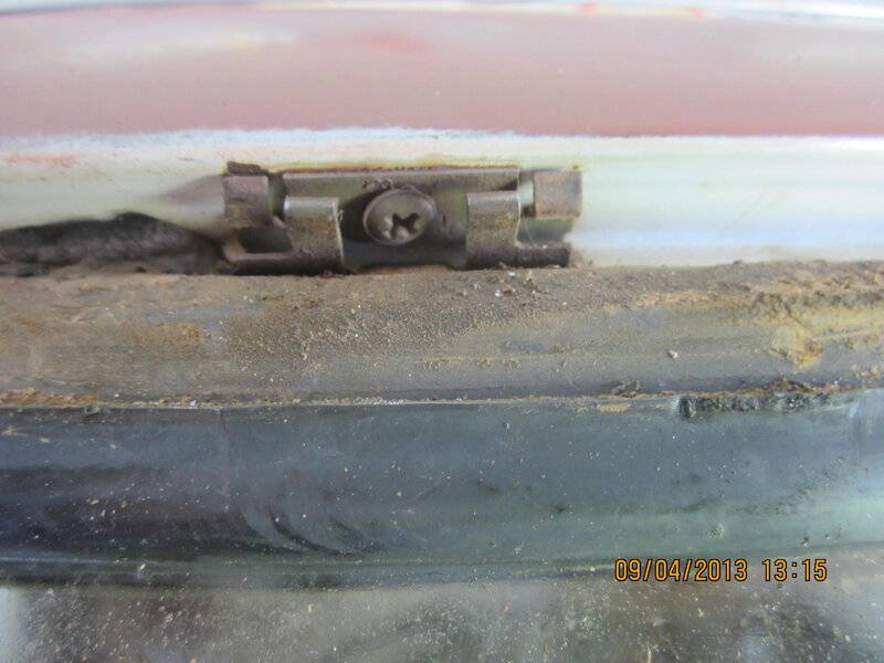

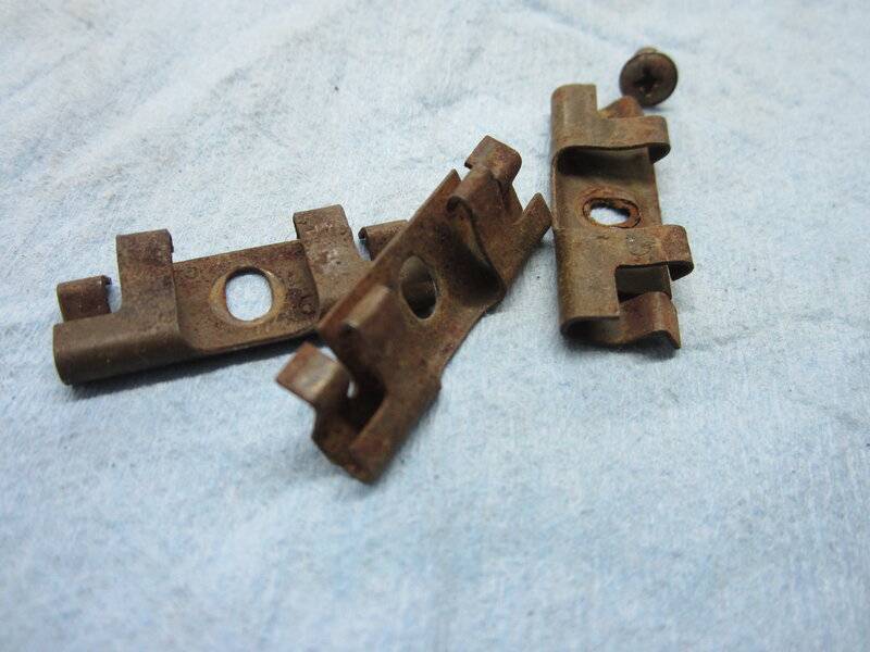

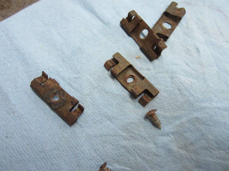

On my 65 Coronet 440 hardtop, Can someone show a picture of the correct installed trim clips for the windshield and rear glass. Thank you

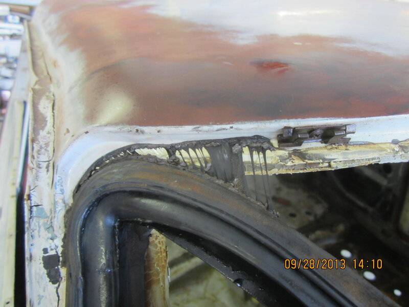

Photos of my 1965 Coronet Hardtop Front windshield clips.

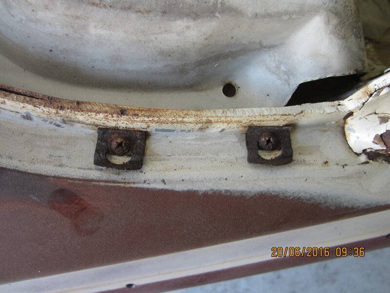

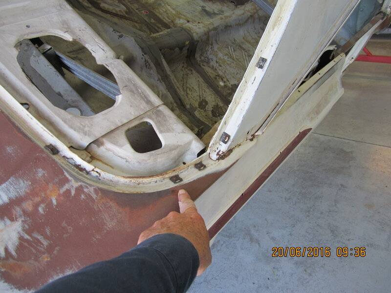

Photos of my 1965 Coronet Hardtop Rear windshield.

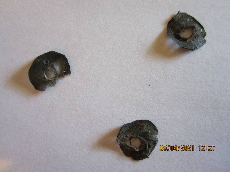

Forgot to mention there is a tiny round, thin, black, gasket between the clip and the body. I'm planning to just use a tiny spot of silicone.
