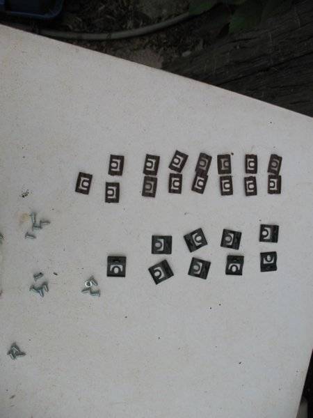

1968 Coronet. Can someone tell me if 24 is the correct amount of clips, and which ones go where?
If the 68 model year car was built prior to January of 68, then it will have the cowl using the 66 to 67 longer style of clips. The picture as shown in post number 1 is the mid year 68 to 69 kit. The 70 model year used a different style A-pillar clip which is not available in a reproduction style, so everyone just uses the mid year 68 to 70 for those cars.
We put 22 clips into the kits that we make up.
