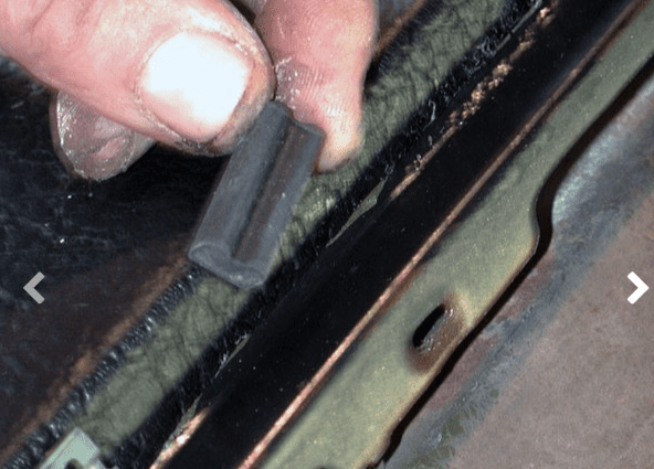

Are your hard rubber spacers there?
Basically it's centered you need those blocks though ! I just bought a parts duster should have them I can steal out of it
This is the stuff you need. https://www.hotrod.com/articles/mop...ent/#mopp-0907-01-pl-71-roadrunner-front-view

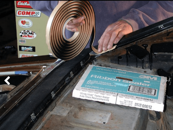

The rubber setting blocks set the height of the glass (installed at bottom edge of glass)
The butyl tape sets the depth of glass.
