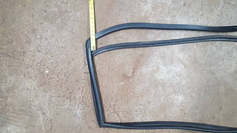

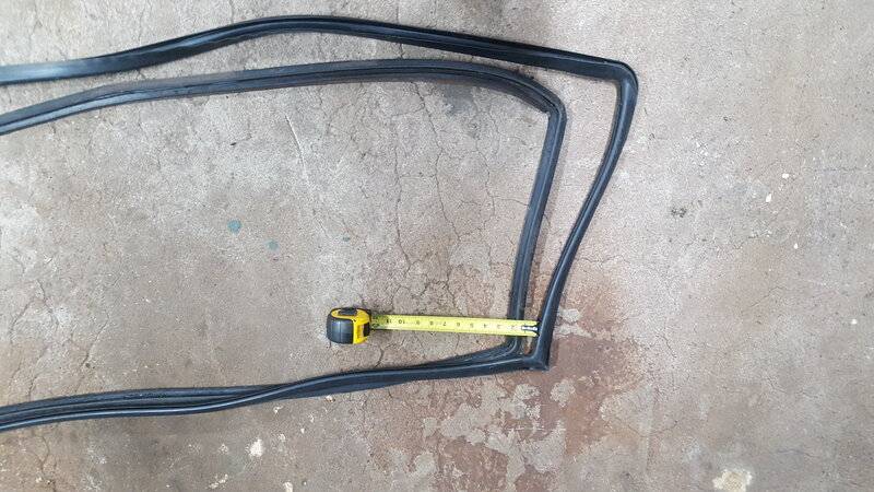

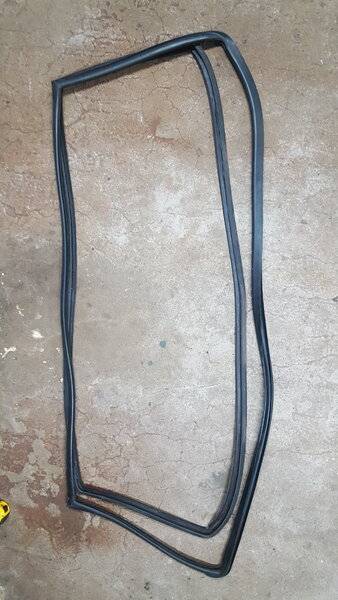

Doesn't fit for S-H-I-T on my 62.
It's bigger than the opening, bigger than the old gasket by a mile, and it's 2 inches past the edge of the window side, without the window slid into the gasket.
Old gasket was hard as a rock, so I trimmed it neatly, but can't reuse it.
What am I missing here?

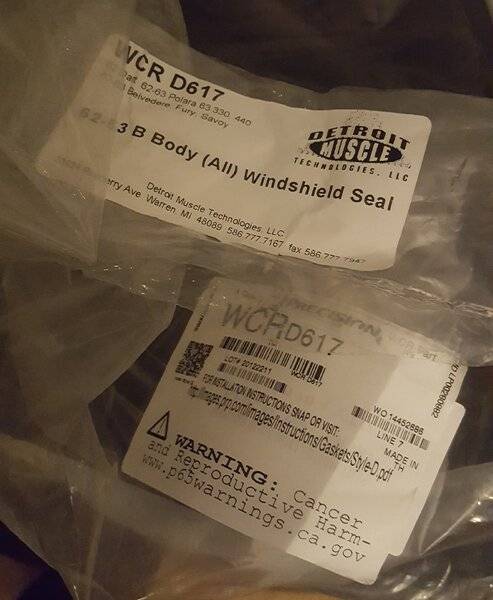

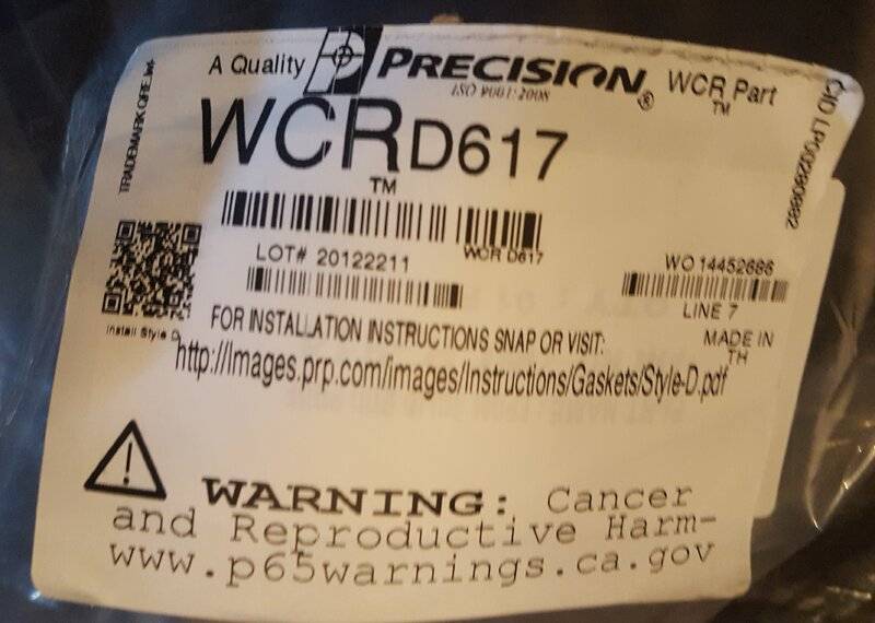

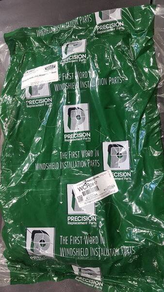

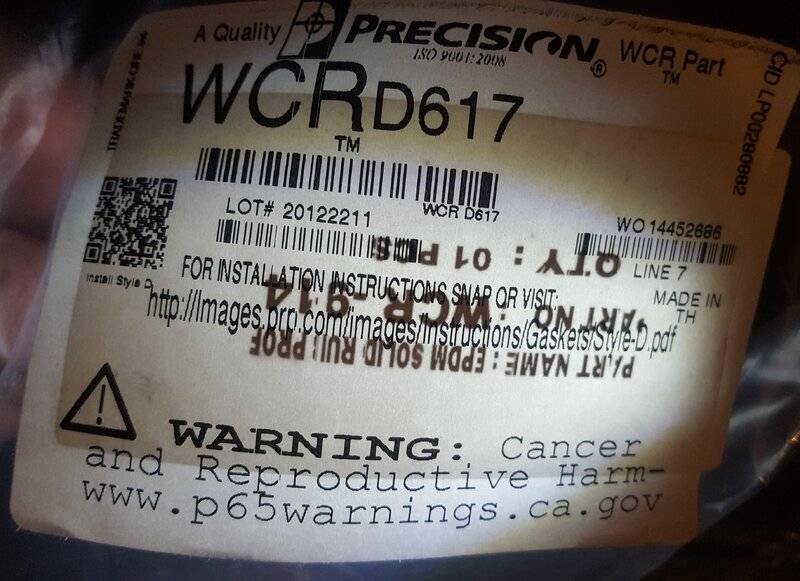

So I'm told the Precision seal should have a label heat sealed into the bag.
Also, that sedan seals are larger, as in they don't fit "All" models. DMT sticker states otherwise. Yes, my first response was to call them but they were closed, and I will be calling tomorrow asap.
The I discover the sticker below the sticker, on a completely sealed bag. WTF!

Matt,
You have a 72 to 93 Dodge truck gaske, part number WCR 914, I bet. Look at the bottom label.
Richard

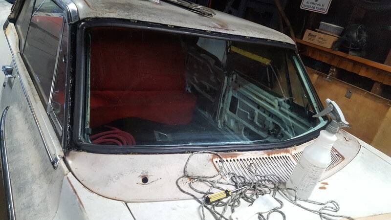

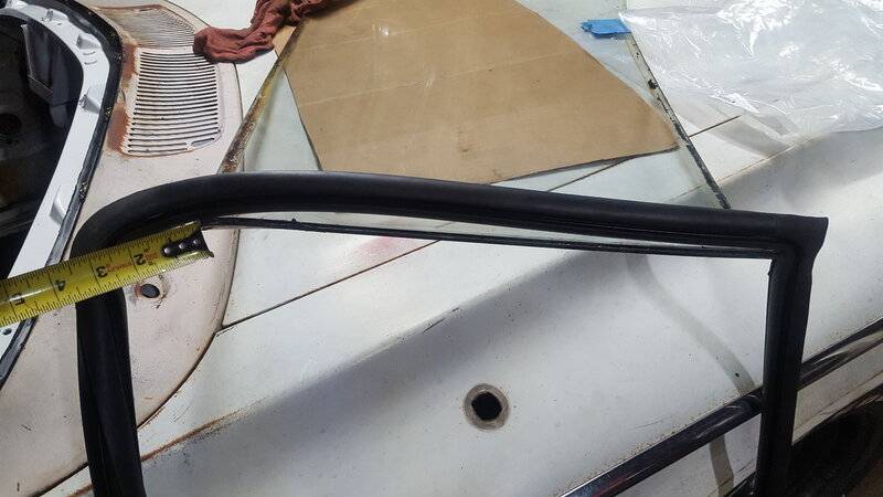

Bag is completely different, not sure that matters, fits perfect.
Used the 3M bedding stuff, then went and grabbed windshield and cleaned it.
Supposed to be a pain in the butt job only professionals can do. Manual states to put in top first, not possible alone so I did bottom first.
Just the windshield install alone, seal already in, done in 55 minutes.
Nylon cord in windshield channel, hot soapy water, plastic scraper. After it was in, screwdriver used to lock a few stubborn parts of the seal.
