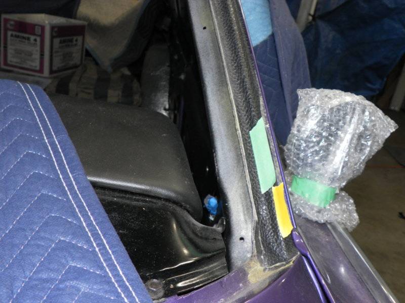

1st time for me on windshield! where do I cut the new vinyl on windshield frame edge? by edge of green tape or edge yellow tape?
You want to wrap the top into the channel but just on the face. If the yellow tape is the front of the pillar you wrap it behind where the trim clips go and no further.
