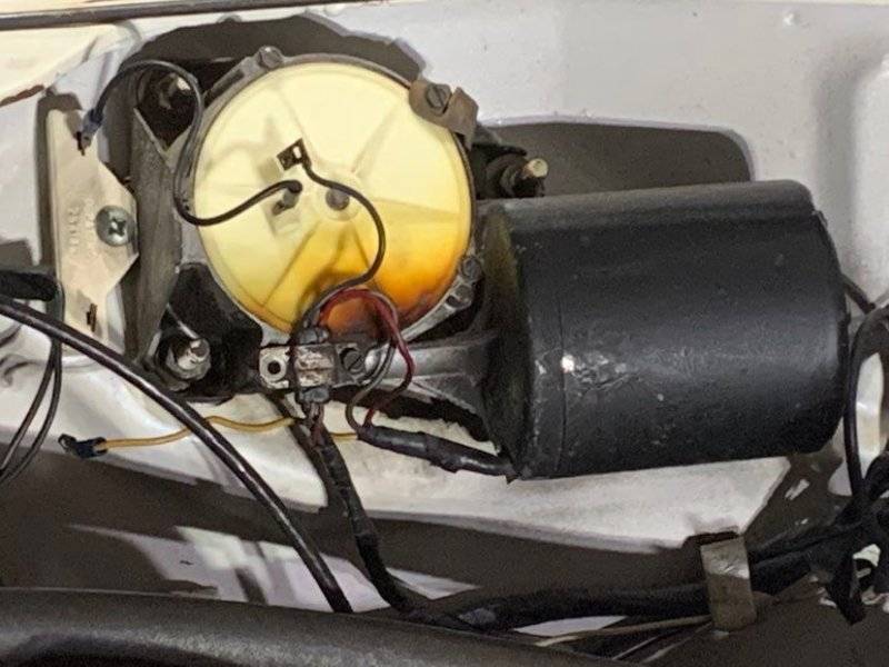

Can anyone point me in the direction of the wiring diagram for my 2 speed wiper motor? The wires were disconnected from the ballas to the wiper motor and both low and high speed work. Just won't park.
Thinking the parking issue might be with the wires off the ballast, I connected them both. When I turned on the ignition, the wipers ran, eve with the switch "off", so I disconnected the bottom one as you can see.
Just trying to understand the electrical flow to the motor.
Thanks!
That's a picture of a 3 speed motor. The 2 speed motor is totally different. Do you have a 2 or 3 speed switch on the dash? You might have mixed matched parts.

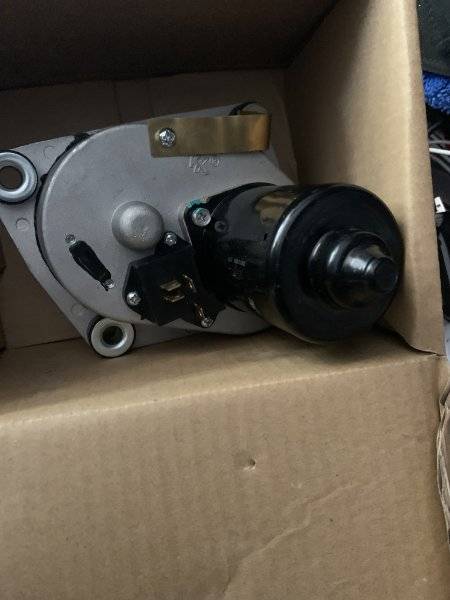

Thanks Tony! I have a 2 speed switch on the dash. This is the motor I received today and it’s totally different.
I guess I need to figure out how to wire the new one since the existing wiring is all screwed up for the 3 speed...

If I read the new wiper motor info correctly, it is delivered in the "park" position, so I need to keep the wipers in the park position.
