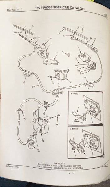

Hi I’ve been trying to remove the wiper assembly on my fury sport but I can’t figure out how to separate it. I took the 3 bolts off but after that I believe I need to remove the arm pice but I can’t figure out how to
To remove the wiper arms you need to pull out on this tab then straight up on the arm and it should come off of the spline shaft.
Here is a diagram that may help.
