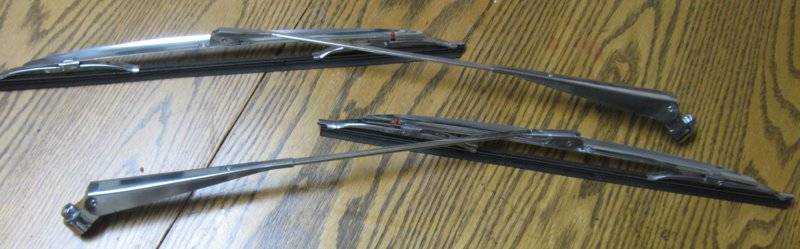

Who would have thought that wiper blades would be so hard to find BUT they are. I was looking for years for new complete assemblies for my 64 dodge and last year during the summer I got an Nos pair for my 64. They are mint with nice soft blades. I could not believe I found them as I looked for decades....
