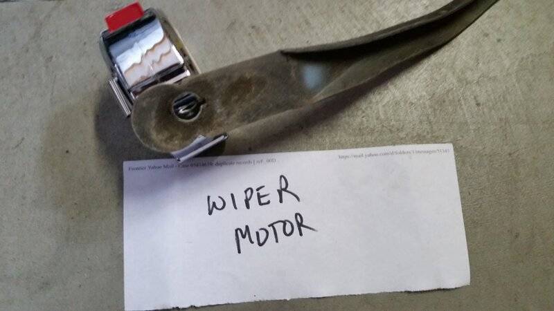

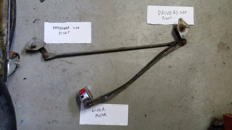

I'm having trouble figuring out what parts I'm missing for the wiper linkage on my '73 RR project. How do the linkage rods connect to the pivots and what hardware is needed to put it together? Is anyone selling these parts new or do you have to get them off of a salvage car? I have the pivot, rods, motor and wipers, but nothing else for some reason. There are remnants of something hard (like plastic bits) around the pivot points, but nothing usable.

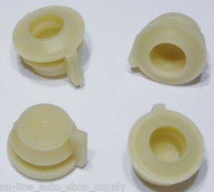

Two speed or three speed wiper motor? There's a different mount there depending on motor, but the rest takes the same bushing. They were available in the HELP section at auto parts stores, but can be had on ebay or other places online.
These bushings were used up into the '90's, so they're not year specific.

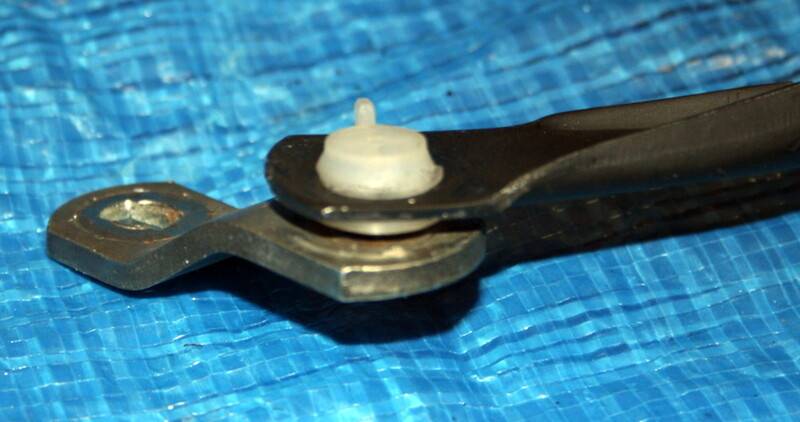

My 74 has the linkage only attached to the driver side arm. So I discovered that I need a connecting bushing, which I picked up from ABC Auto Parts in town (had to order a pair but it only took a day to get there from Dallas). But I distinctly remember seeing somewhere in a diagram someplace that there is also a flat metal plate or clip or something that goes either under the bushing or under the linkage or something like that. So I am wondering if I am mistaken here or if I am missing a part?
So I installed the bushing, and even though it took 3 people, 2 sets of pliers, a flathead screwdriver, a bunch of baby soap, and some prayers it finally popped into place. Note to self: next time, remove the assembly from the car first. It seems to work okay so far, although when I turn them off they do not go down into their hideaway position (have to physically push them the last bit down). I did not use the "flat metal plate" I mentioned earlier since I didn't have one. Doesn't seem to need it although I'm sure it will let me know if it does as soon as I'm driving in the rain.
