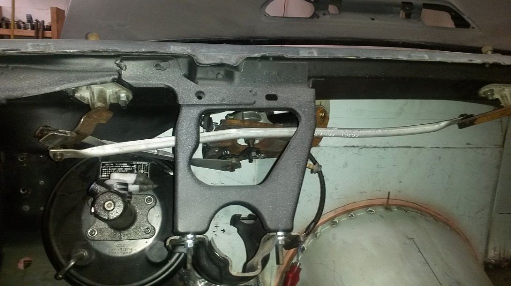

Yep , I did mine. I used a Toyota wiper motor though as it was more compact. Makes engine bay so much cleaner looking. I was lucky as had changed everything under the dash including the brake pedal bracket so I could just custom make bracket and weld to under dash panel. I also had to shorten link from wiper motor to pivot. Its a job best done without a dash in place

Here is a photo of the wiper motor mounted. Not the best photo sorry. I will see if I can find some more.

Which Toyota wiper motor did you you use? And if you have more pictures, it would be appreciated. Want to do the same thing to mine.
Haha, I knew someone would ask me this. The model vehicle is a 1996 Toyota Hiace, unfortunately these were not sold in the US. You can use any wiper motor and modify bracket to mount. I also had to modify the short arm that attaches to the motor spindle as it was different from the original.
