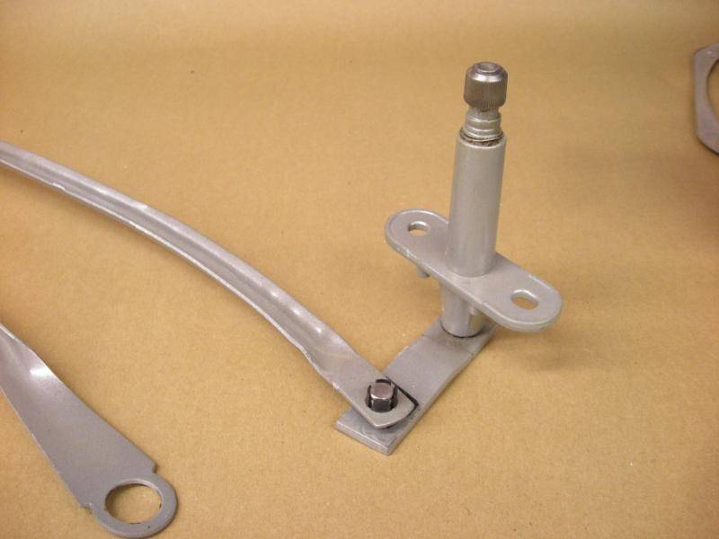

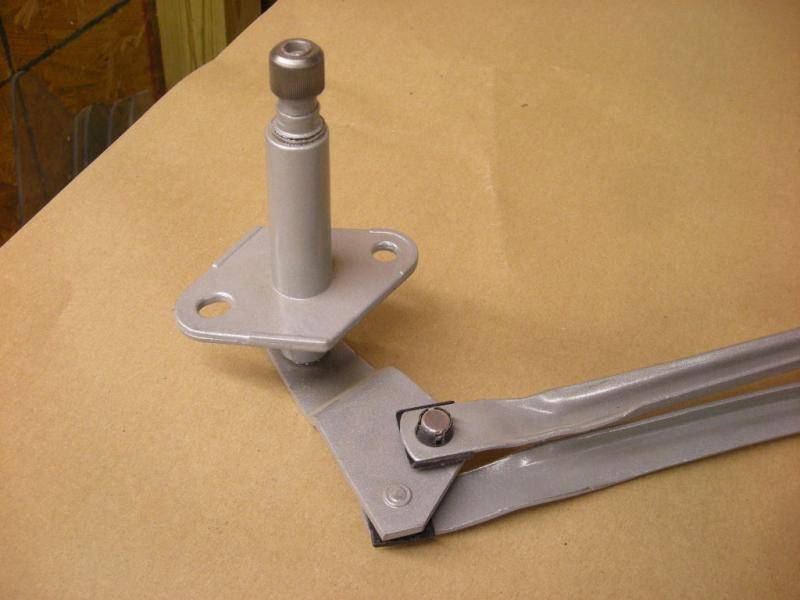

Hello,
I got a question. I am here in Germany and B-Body parts are very rare. Now I destroyed my right hand side wiper pivot. I can only get another left hand side pivot. Can I use it on the right side too?
Maybe with little modification?

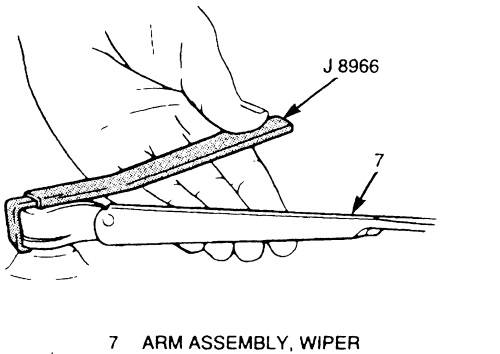

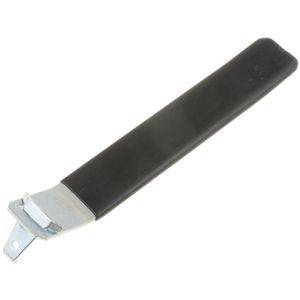

Use this tool next time:
https://www.rockauto.com/en/parts/lisle,65750,wiper+arm+tool,335

I am talking about the pivots. Can I use a left side pivot for the right side? Somebody ever tried that?
I will take a look tomorrow, I have some parts but think they are C-body.
Thank you guys so far. Because I am in Germany and B-Body parts are very rare and much more expensive I was asking If I can convert a left side wiper pivot to a right side pivot. Maybe cut the edges straight and weld the original right side crank on it.
I have two left sides and a broken right side. Trying to figure something out.
