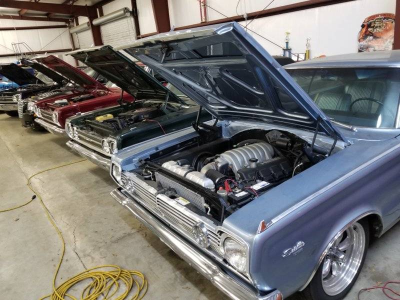

Griffin View attachment 1008924
A/C 6.1 Hemi 727 automatic, no overheating.
413 Max Wedge, automatic, 22" Griffin no shroud, Max Wedge clutch fan. No overheating.
They work, on the pricey side, but you only do it once.
