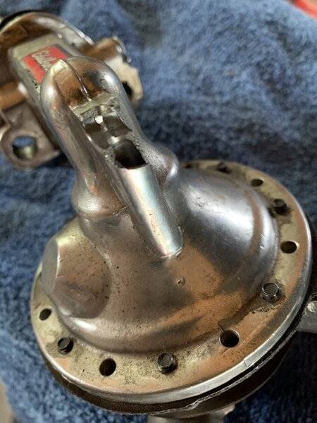

It was the fuel system, thank you very much Sam Dupont! I took the pump off and I see a chunk out of it! Could this be the problem?
did it fire up when you put gas in the carb? look in the hole can you see the fuel pump diaphragm.
Catastrophic pump failure. Never done it myself, don't know how, but I would try to ascertain why it failed. Is something binding or was it a poor casting from Edelbrock?
pull your pump rod out and check it and measure it,time for a new one.
