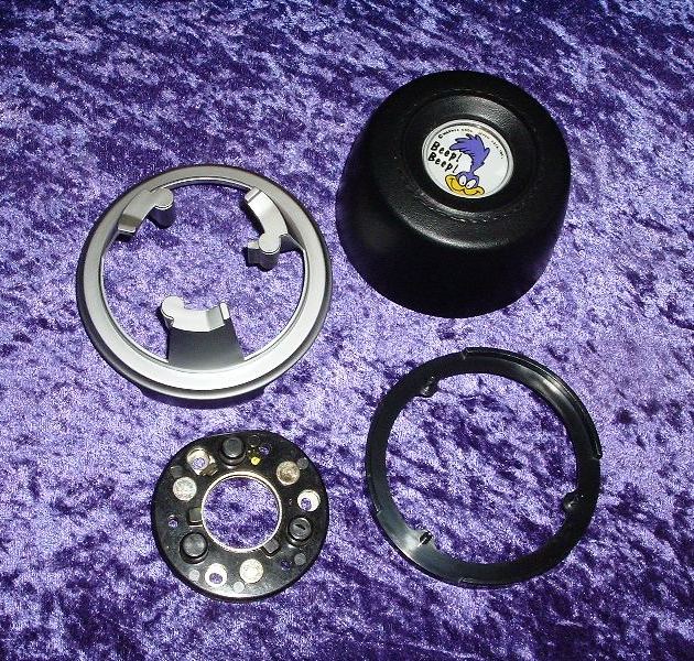

I have a simulated woodgrain steering wheel for my 1970 Roadrunner, but I just have the wheel.
Does anyone have an exploded view diagram of the pieces I need to install the horn? OR Can you list the parts?
For a complete wheel, you need:
  • Steering wheel
  • "Retainer" ring
  • Horn Pad
  • Emblem
Anything else? :eusa_think:
Thanks in advance for any help!
Hawk
For your 1970, you will also need the black plastic spacer that goes between the steering column and the steering wheel.

Thank You!
Awesome. This answers both the questions of what I need and where I can get it. THANKS
