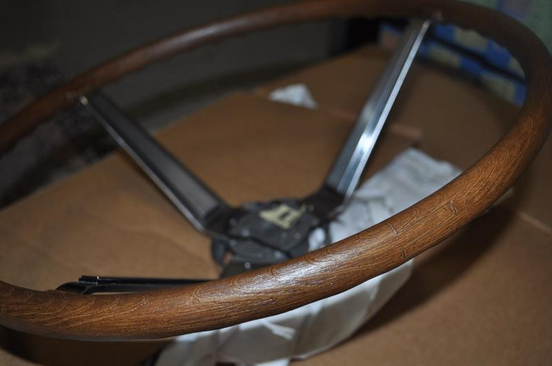

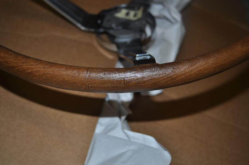

062.jpgView attachment 93784

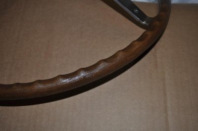

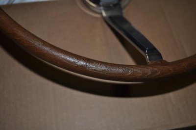

http://garyssteeringwheel.com/ Gary did this one, had several cracks overall bad condition. He is a class act and excellent restoration source.
Gotta Confirm Gary's work! This one is the original (finished) wheel from my `66 Belvedere. When he started the whole ring was smooth, except for the finger reliefs...they still had a small bit of 'wood grain' left in them.
He put the three dimmensional grain back into the entire wheel.
Including the simulated wood joints!
Cost is not a whole lot more than an aftermarket wheel, and in the end a very unique piece that gets plenty of compliments

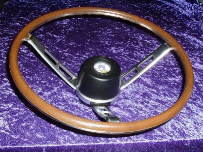

For the best results, send it out to a professional. There are only a few of us that have the reputation and experience to make your wheel look right and last a long time. We use only the finest professional materials and techniques so we can stand behind all of our products and services. If you decide to do it yourself and you use anything you can get over the counter, including the PC7 like in the Eastwoods kit, it may look good while you're repairing it, but as soon as you expose it to any temperature extremes, it will crack right back out.
Dave

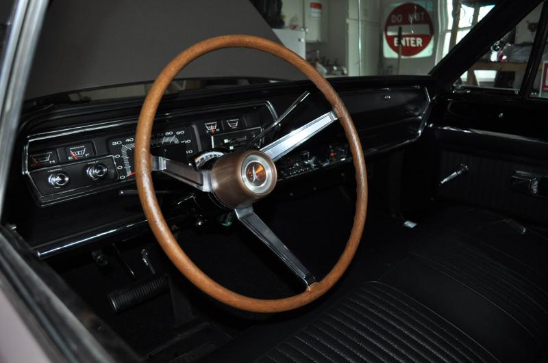

Hey Plum (or other wheel experts),
I have a 70RR with the black (bakelite?) steering wheel and it's got "cracks" 1/2 to 3/4 inch wide - missing material right down to the steel hoop. That HAS to go to a pro I assume. Anyone have a good recommendation for a wheel that i can use in the meantime? A decent Grant wheel or whatever? What a-dapter kit (Johnny Cash quote) do I need?

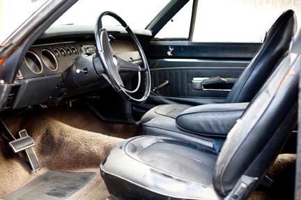

My wheel doesn't have the soft black raised center hub like the one shown in Plum's picture. It has the flat center with the Roadrunner emblem. Sorry not a great photo...
Greg
Greg,
You have the most common wheel in your Road Runner and yes it can be repaired. In 70 they made the wheel with a "pebblegrain" type finish which is nearly impossible to restore (reasonably). The good news is you can get a brand new one from Mike Ross at BEAPARTS.COM for less than restoration costs. Plus it will have the pebblegrain finish and be made from modern plastics that will most likely last longer than your original. All of your parts will swap over to it too. Tell him I sent you.
