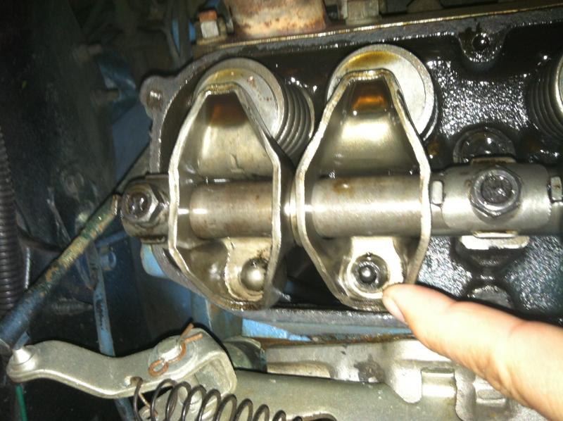

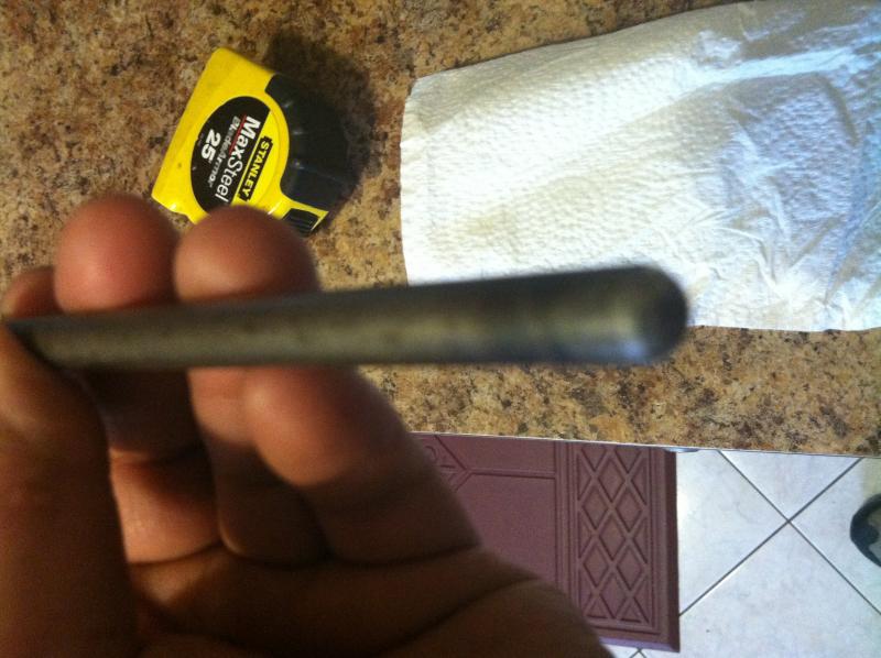

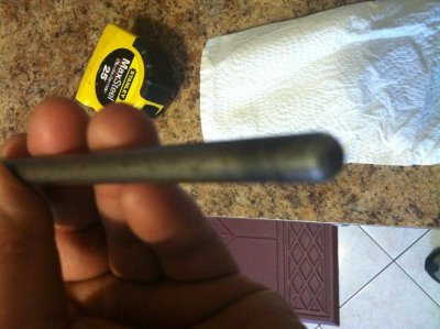

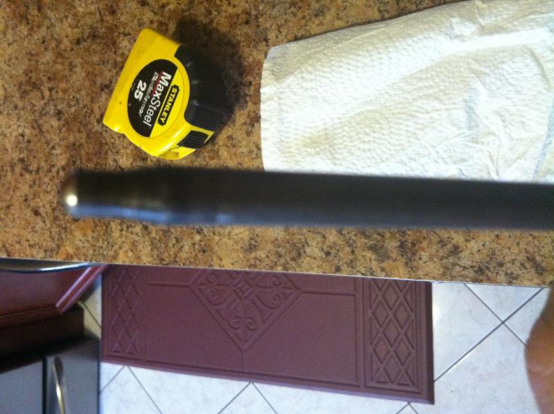

image.jpgok so I got up took care of the honey to do list and had tv on in background and I hear Walter Matthau in the bad news bears tellin kids that quitting is a hard habit to lose so I pulled valve cover and found....pushrod through rocker
yea I never put more than 50/75 miles on her every summer since engine was redone in 1993 so im thinking collapsed lifter rod was probably bouncing for a while im so relieved was leaning towards ring job.....
that would do it! how did that happen I wonder? I've never seen a rod punch through a rocker, usually they bend first.
yea I rolled rod didn't seem bent to the naked eye weird.....but its a load off my mind
that pushrod is different than mine,one end is smaller. what year is that?
