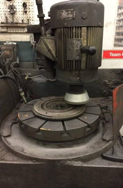

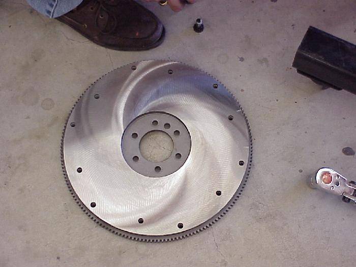

Check it first with a dial indicator while still on the flywheel and with a straight edge to gage how flat it is. Then sand it with an orbital and 80 grit. If it checks out flat, was not chattering when removed and the light sanding removes any appearance of discoloration, dark spots and surface cracks - then I would consider using it without resurfacing.
I’m a machinist. Taking .005 off a clean flywheel will give a nice flat surface. But shops will charge you the same if they take off .05. It would have to have ridges my thumb nail would drag on to resurface.

I have it surfaced or changed if need be

Do it right Do it once. If you have the shop handy have it ground. (not turned)
