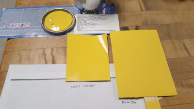

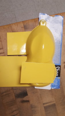

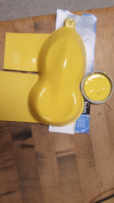

Py4 is not the same, pic shows 3 kinda of base clear, shopline is on the lid $241 a gallon, 1/2 card is spies hecker, last is axalta base clear, about $800 a gallon and is the closest to my original fy1. Code 2211 on all. The axalta has the whiter washed out, pastel look that fy1 has, shopline and spies trend toward in the py4 direction, all look good but for a restoration axalta is winning. You can buy ditzler single stage$1500 a gallon I am told.

Bubble is spies heckler, so is 1/2 card, light and angle make a big di

Now you see why no 2 yellow cars look the same at shows, never park 6 in a line.....

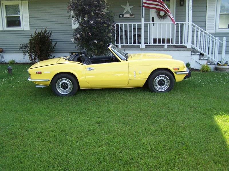

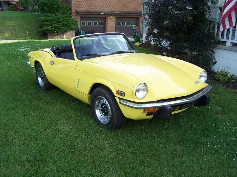

Here is a test spry of PPG shopline Lemon Twist Y1 that I dd on a Spitfire last year to see how it covered.

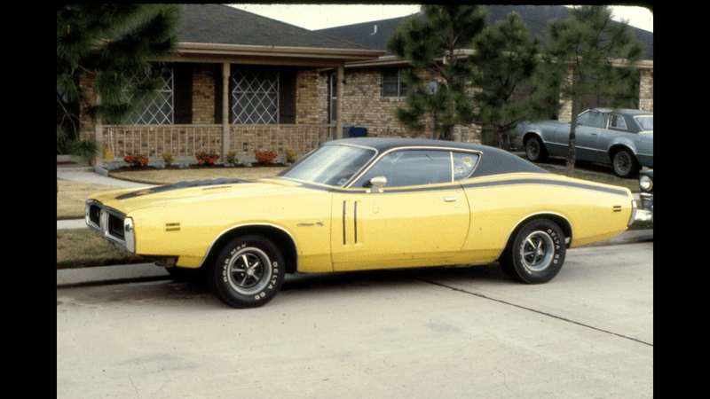

Here's a computer scan of a 1978 Polaroid picture of my 71 Charger R/T original paint. I remember it was a softer yellow than what is on my Roadrunner now.
