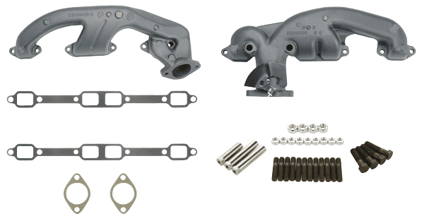

Does anyone have experience with these ? I am considering a set of these for my 77 since TTI says they can not connect to my existing factory manifolds.
I purchased the passengers side one and it was fine with a little tidy up with a die grinder in the first part of the manifold.
Good repop in my opinion.
my 400 in my 77 has small manifolds with 2.25 outlet ball socket style. I figured these would be a good upgrade over what I have now. also i cant find anyone that makes a down pipe for my stock manifolds.

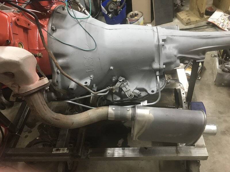

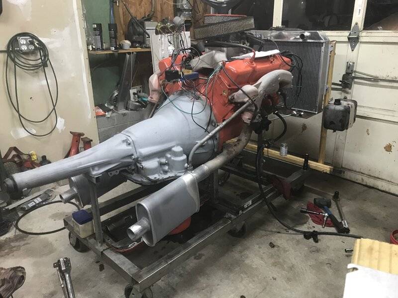

These in this picture are the Year One repops. I had the down pipes from the 69 Roadrunner left over after swapping to headers. They just use a flat flange and a bent piece of pipe. Buy the flange that fits the HP exhaust and then have a muffler shop do the rest. https://www.oreillyauto.com/shop/b/...xhaust-flanges---universal-19035/a98cd32ca2e3
View attachment 985544 View attachment 985545

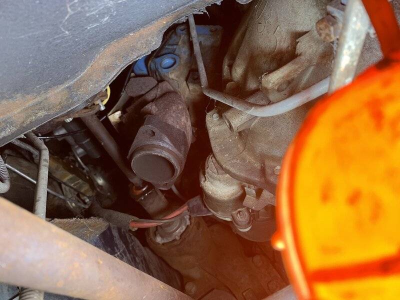

This is my current manifold which is "ball&socket" style. The ID on these is only 2-1/8"
