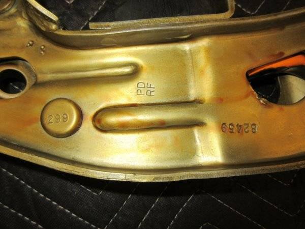

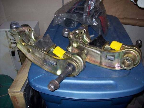

I have seen a guy do that years ago....As far as I know it did not crack etc....
Here is the pic....
Thanks for the pic. I had pictured something more shiny....any other ideas for that look?

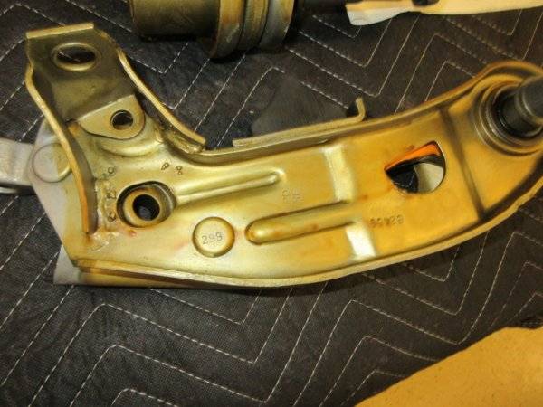

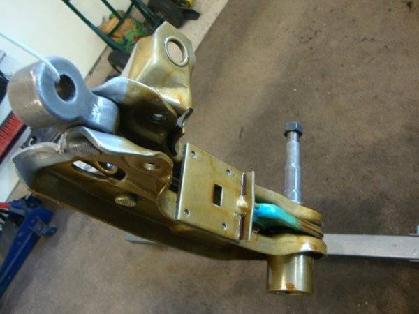

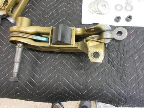

Here are some Cosmoline pics using Eastwoods product. This is on my current restoration the GTX...The ends are bare steel...
