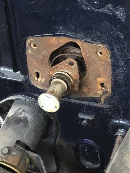

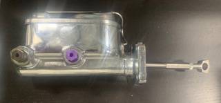

That's not what I have.
Here is what mine looks like.
001 is what right stuff sent. They said that it's all I need.
002 and 003 is my current set up
Thanks
