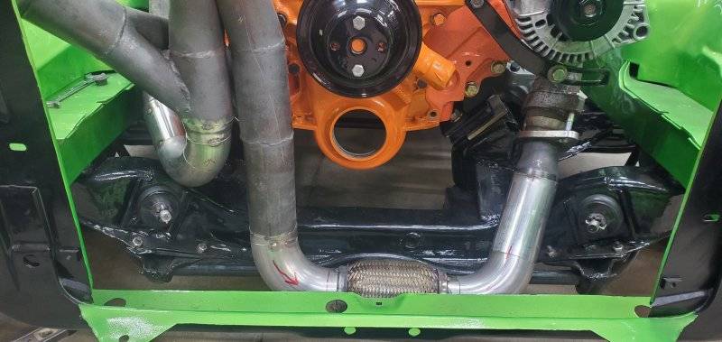

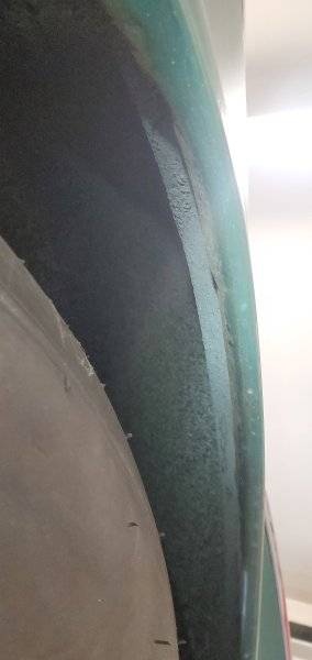

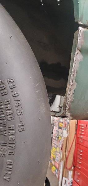

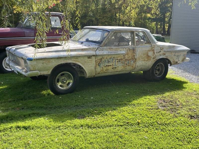

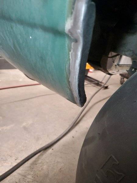

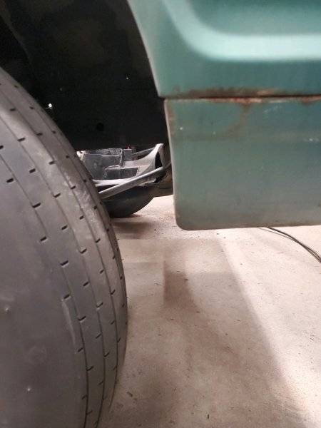

Helping my son get his 62 converted from turbo street car to full on N/SS racecar. He's done a lot already. Motor and motorplate, header fitment, fuel cell and lines. I'm swapping the 3.54 for a 4.10. The 28" tires wouldn't fit. So I hot creative with the front fender. Trimmed a pie shaped piece out. The pushed the wheel lip forward about 1". Rewelded and metal finished. The paint is of no concern as it is original, worn thru, and faded.
Doug

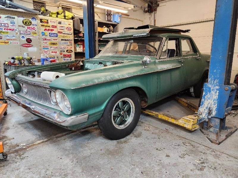

Pretty sure I've seen this car in person at the track. Coolness factor of 10 on this one. I don't think i'd paint it overall for as long as you get away with it as is. :thumbsup::thumbsup:

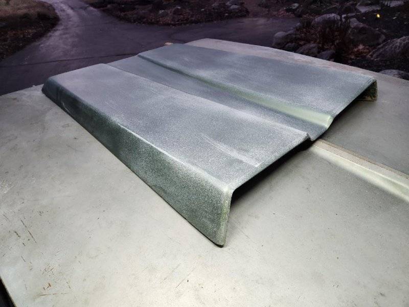

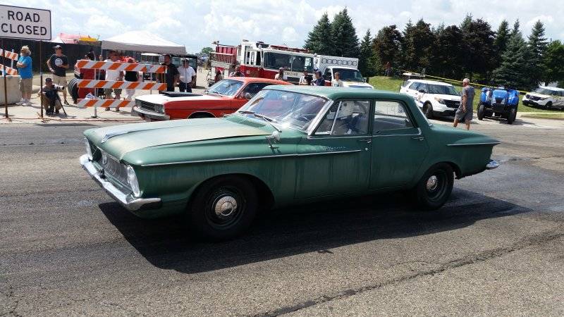

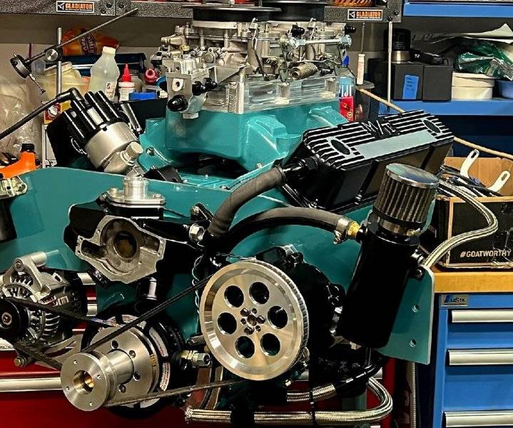

Hub caps when it was a sleeoer turbo small block. New wheels and hood scoop now. Tried to make the scoop paint fit the look. Hood was repainted sometime early in its life from another car. It's blue underneath the paint. So it doesn't quite match. Motor paint is top notch.

Oh, and the front edge of my front fenders have been trimmed back a couple inches too. Running a 235/75x15. Only rubs on the header tube in the wheelwell.

Love this. Engine looks awesome. Looking forward to seeing all the little “DVW“ items and tricks that go into this buildup.

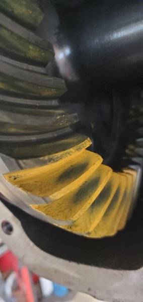

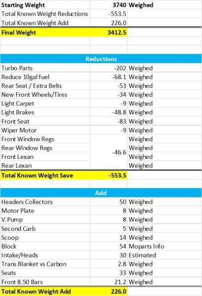

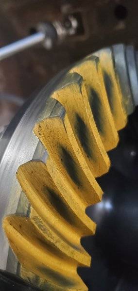

This was yesterday afternoons progress. Setting up ring and pinions is one of my least liked jobs. It takes me way too long. But it looks close. I'll put the real bearings in it today and button it up. Should come in around 3400 w/driver. See chart. Our bet is it should be easily able to run C/FX 9.75 index. Maybe 9.59's in good air. Not sure how many "tricks". I'd like to think at least I influenced the engine apperance.
Doug

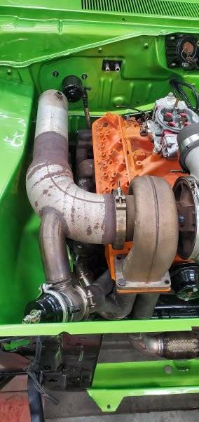

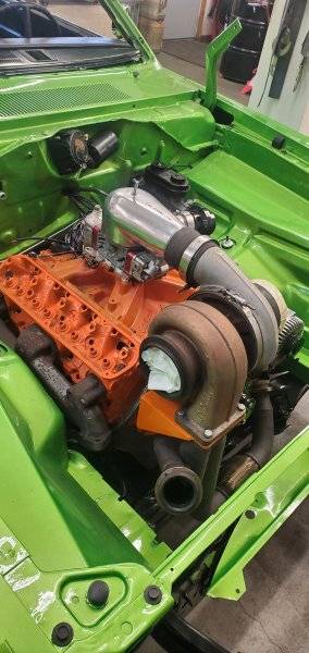

It did finally hurt a piston. Been bored and freshened up. Going into a Duster street car. Just plumbing the turbo piping on a mock up block now.

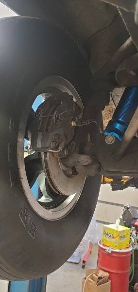

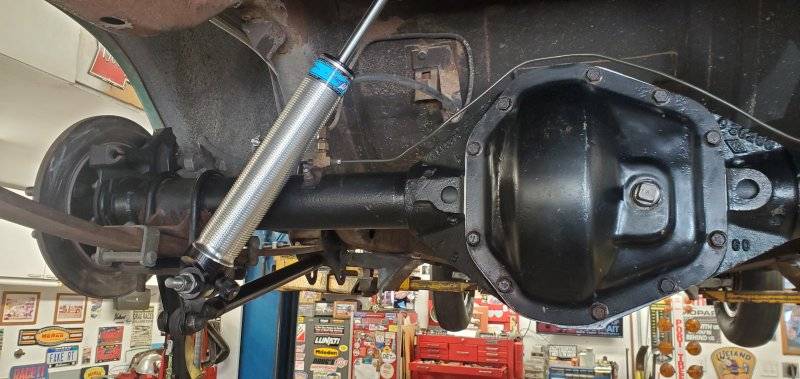

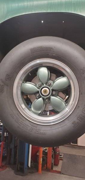

Not a show car. But the rear is buttoned up. 35 spline, spool, 4.10, Cal trac, fresh Menscer shocks, Explorer disc brakes. Front is ready as well. Fresh Willwood rebuild, fresh Afco doubles, and my old American 200S with M/T 28"
Doug

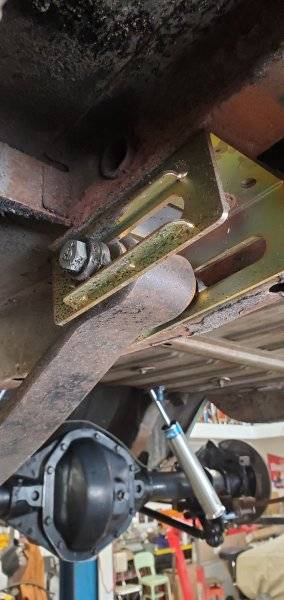

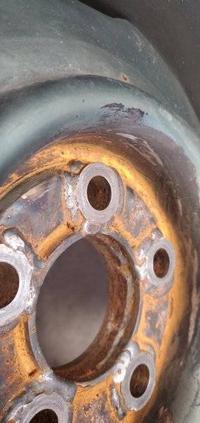

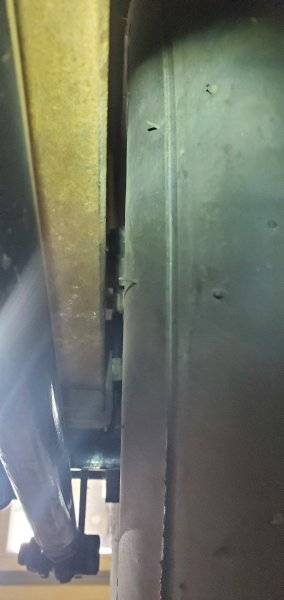

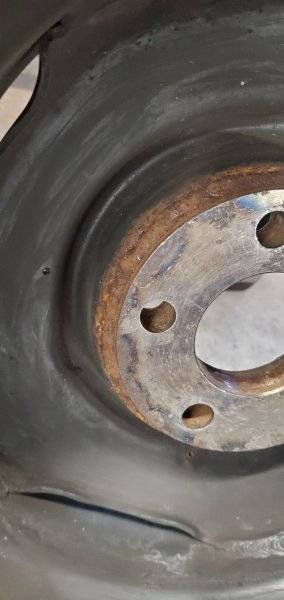

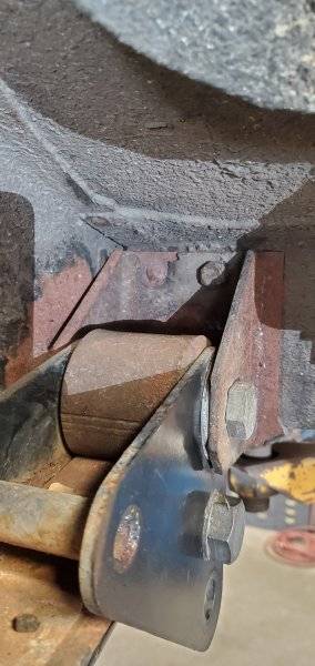

The amazing part is with a slight move of the springs and a rolled fender lip, 10.5x29.5 M/T Pro Bracket radials bolt right on. The front hangers are flush to the frame. Shackles are replaced with sliders. Early on using steel wheels (10") it bent the rear wheel studs. So steel plates were machined and welded to the wheel for greater surface contact. Also added 5/8" wheel studs.
Doug
