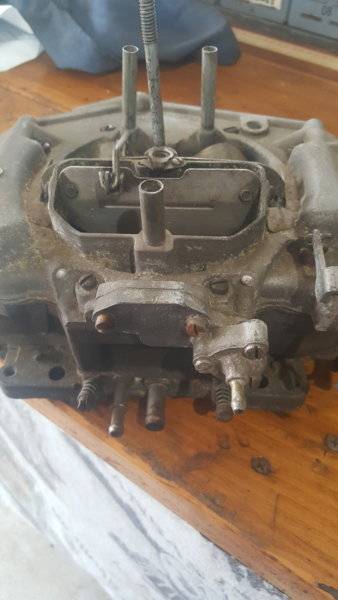

So I am going to rebuild this one for use on my 68 383. Wondering what the vacuum thing is that is mounted in front of the top plate. Guessing something for emissions. Can it be blocked off?
Thanks
"Up front the later TQ’s featured a flat-faced boss on the airhorn. Carbs of this configuration were revised with an auxiliary air bleed circuit that affects the fuel mixture. On some carb variations, this front boss was left un-machined and blank, defeating the additional air bleed circuit. Chrysler used three variations of controls on this air bleed provision, most commonly a vacuum operated diaphragm that closed the air bleed to enrich the mixture during warm up. Some carbs added a high altitude compensator valve to the enrichment diaphragm assembly. Our carb is so equipped. Finally, later OEM TQ’s utilized a feedback solenoid here to electronically alter the metering via a primitive ECU feedback system." https://www.hotrod.com/articles/mopp-1304-rebuilding-a-carter-thermoquad-carburetor/
What rumblefish said, plus, did you know the thermoquad wasn't introduced into production cars until 1971?
Yes that's a Cold Idle Enrichment Valve. As was said. Ron
I understand an older one would be preferred. Can I make this one work?
Yes. You may not like the performance of it on a hopper up engine.
