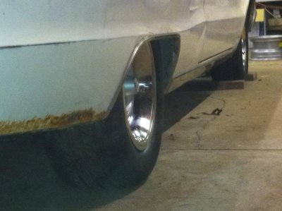

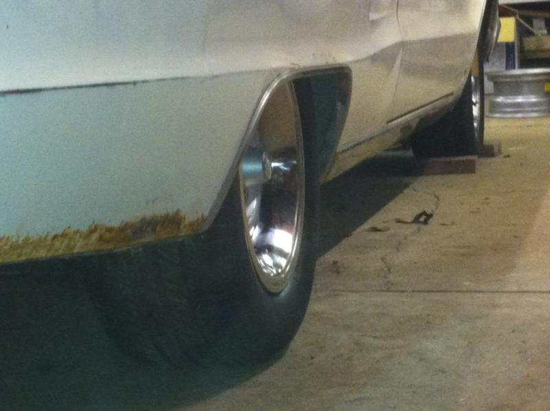

I just went through the same tyre problem, I ended up using a 255 60 15 MT on 8inch Rallye wheel, but I had to increase the backspace by 1/2 inch to make them even spacing under the guards. I couldn't increase it more otherwise the tyre will rub the springs. with the 255 I have about 3/4 inch gap on either side of the tyre. Not idea gap but the tyres look great, and my car is pretty low so maybe the 275 will fit if the car is raised higher. IMG_0471.jpg

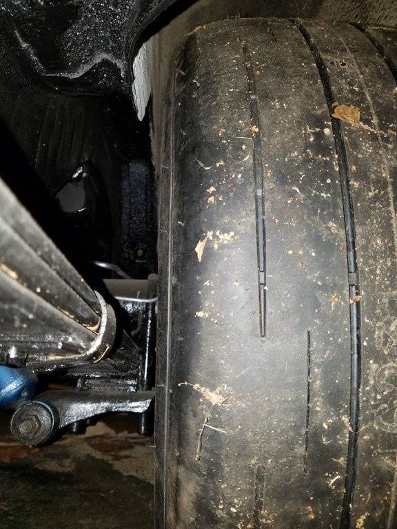

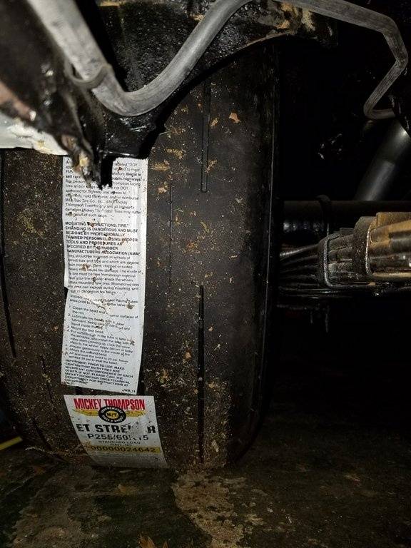

i just took a couple of quick pics, look like there's at least an inch space to the leaf springs. i'll have to get a better look tomorrow during the day.
