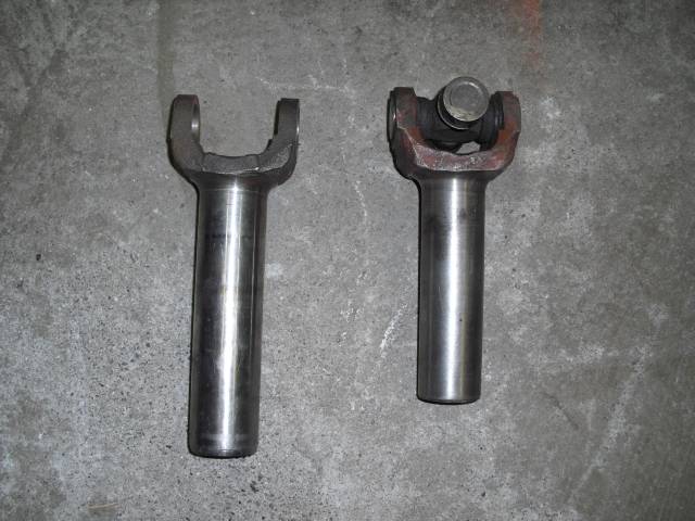

FYI, I have had numerous OEM 727 yokes. They vary a lot. I have an OEM that measures 8" end to center of U joint. Other OEM are shorter. My Mancini forged is 6 3/4 end to center of U joint. Seems to me if you get 2 1/2" of spline engagement or more, you're good. The tailshaft bushing is 2 1/2" long. Anything longer doesn't do any good.

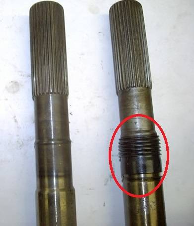

Some slip yokes have a "dead zone", an area in front of the splines that is smooth, this design is intended for use with internal seals. Yokes without the dead zone are shorter but the actual spline engagement is the same.
View attachment 749508 View attachment 749513
Sure would like to know what the shaft on the right (circled) is out of. Never seen one like that. Also my longer yokes were from '70 and earlier shafts. Again the spline position looks to be the same.
The output shaft seal was a '65 only thing but the later slip yokes retained the "dead zone".
