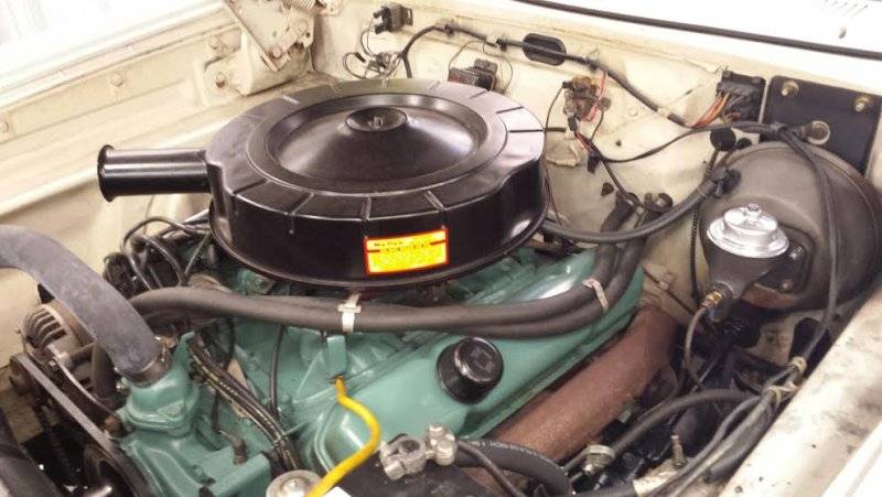

What have you guys found to be the best valve cover gasket for use with stock, stamped steel, big block Mopar valve covers? I have had a couple sets on the 361 in my 64 Fury, and still get leaks. I do have the hi rise "magnum" style exh manifolds, which probably push some heat over to the covers. (And yes, I have straightened the covers around the bolt holes.)Thanks
