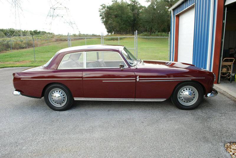

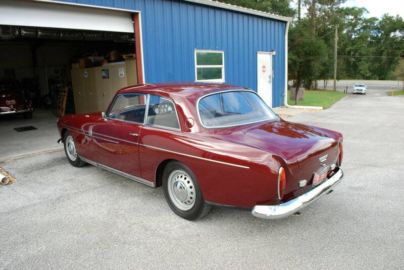

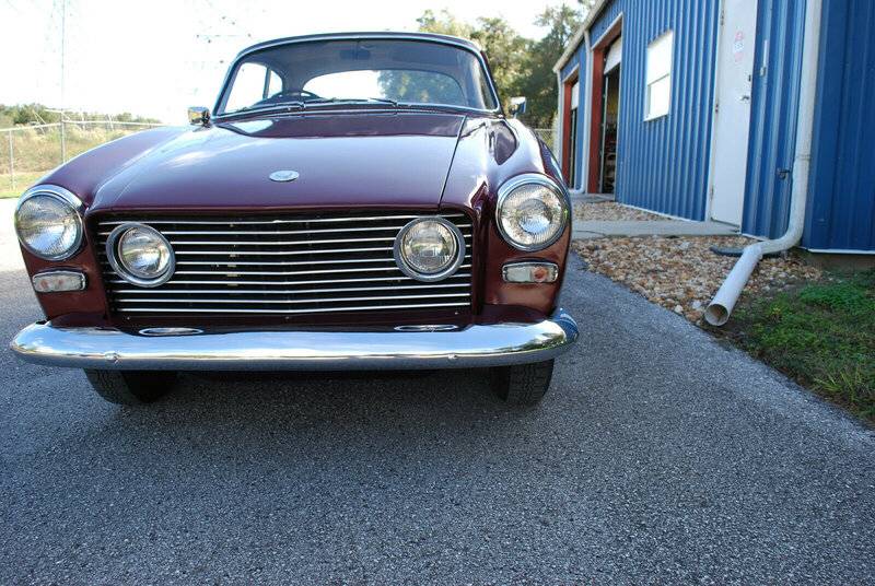

What kind of car is this?
1964 Bristol 408 Had a Canadian built 313 from new but it was replaced in the 90s with the rebuilt ex-Monaco 360.
