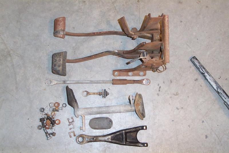

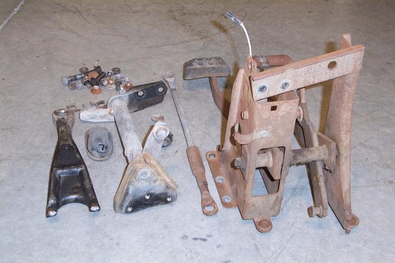

Heres a pic of the setup. 62-5B

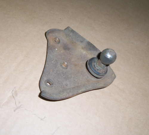

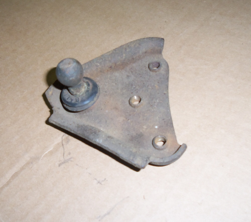

Here is a pic of the bracket. $20 plus shipping if you need it, Sorry, no pics of one on a car.
Pm me
Pm me
Yes, that is the correct bracket. 20 bucks is cheap....I had to fabricate my own once ( for a '64) and it was a real Pain In the As$.
