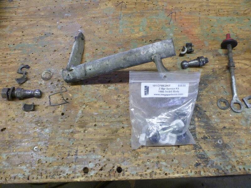

after cleaning the one on my bee it looks like it zinc coated can’t tell if it was bright or yellow but for sure coated
My OE before cleaning. You can just see a hint that it may have been yellow zinc'd originally. I've been under these cars since 1976 or so and don't remember any that where bright like the repro's. I just cleaned it up and RPM'd it before install. Throw out fork rod shown is from an A body, that transitioned to the Bee when the Lakewood went on. OE x B bodies are shorter...
