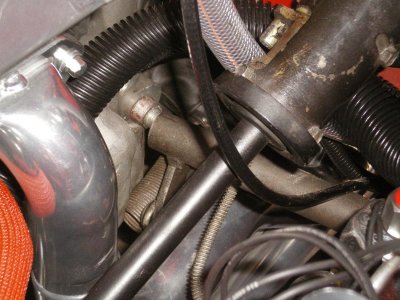

I installed a tko600 in my 62 Plymouth and now I'm having trouble getting a decent ajustment out of the clutch(petals to close to the floor). I used there bell housing and it makes the z bar mount lower on an angle and I think it throws out the goemetry out of wack because of the angle. Has anyone else run into this problem??? If so How did you go about fixing it?? I didnt really want to fork out 650 bux for a hydr slave unit!:VB toast:HELP!

It does seem like the lever that the pedal rod runs would be farther away in this position. Maybe try a longer pedal rod?
You know that ball stud isn't the right one for a 62-64... There are a few different ball stud styles available that might get the geometry back. Does the kiesler bellhousing accept stock ball studs ad clutch forks?
check out the ball stud plate in this pic, this is what my 64 has. It raises the location a good 3/4"

I didnt know this wasnt right for the 62-64 mount but then thinking about the 69 bb bellhousing that come out of the car isnt right either.The keisler accepted the ball mount on the lower hole but just above that hole is another that is smaller in size.This could be how the one you show fits and bring everthing back to normal. How does it mount??? slotted hole on the bottom?? or top got any pics??
THANKS!
I can get a picture for you late today, but I am pretty certain that the round hole goes where your ball stud is now, and the slotted one goes above it. Basically in the picture above it is upside down.
Actually in this pic you can see the two bolts it mounts with, and just imagine it mounted how I explained above :drunken_smilie:
The mounting pads for the ball stud brackets are different through the years. As you can see mine has a flat face where the bracket fits against it. Your bellhousing looks a little different so make sure you look at that Brewer's page to see the variety available. Kiesler should be able to tell you which is the one you need and Brewers could help you too.

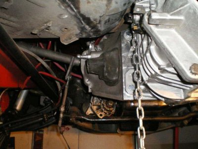

wel that kind a makes sence but can you give me the distances between the holes on the ball bracket?I'll measure up the Keisler bell to see if its compatable.Trying to call keisler tech support for two days now and nothing but on hold! a pain in the A$$!

I'll get some measurements for you later today but it might be different than what you need.
If Keisler doesn't have what you need as a ready to go part, or a recommendation on what part will work for you... your best bet would be to make your own plate to bolt on and then thread or weld your existing ball stud into it. Just get your z-bar in the perfect spot and then measure where the ball stud should be located. a simple flat 3/8" plate looks like it would do it.
If you can't get through to keisler, call brewers. They are easy to get a hold of and always are happy to help.
I measured the bracket - looks like the ball stud is 1.0" above the centerline of the lower bolt and 5/8" of an inch farther back. Those are approximate since it's hard to measure it exactly with the Z-bar in place. At the least it's getting you in the right direction.
Hope that helps.
