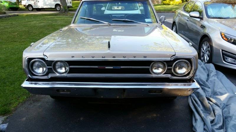

not the original paint...but I always thought this was painted citron gold
GahgFFoYVG4dFT4n2
yea, mine has more metallic. Don't know if its Gold Poly or a custom blend with more metallic.

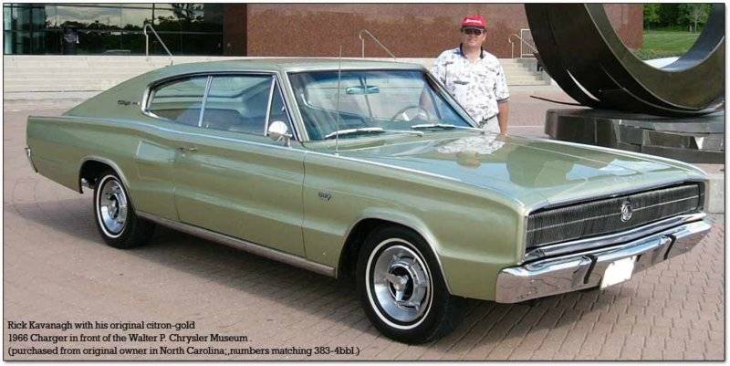

I found these pics of an original Citron Gold 66 and one that was painted. The 1967 looks different. The paint chips look different as well. They also have different numbers 1966 = 22511 Dupont, 1967 reads something else.
