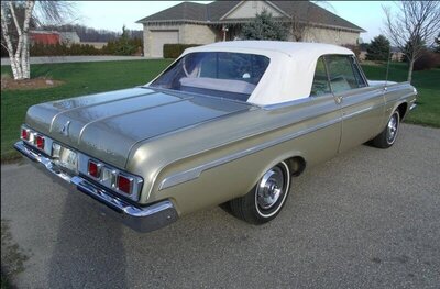

Yes anniversary gold with a white top.
Here is ZZ Anniversary Gold 1964 Polara 500 that I restored and sold.

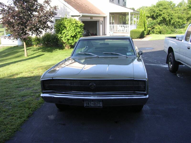

My 66 ZZ1 is faded beyond recognition. It was repainted sometime with laquer and is dead beyond buffing. (I have tried) Kind of gold, kind of green for 66.
