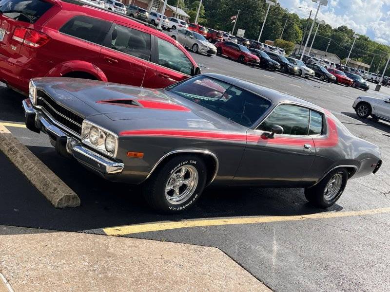

Good bye highway gears. Hello 3.55
Airwolf222b
6:29 AM
Jun 5, 2023
18
83
kentucky
Just swapped the highway gears I had (2.73 i think it said) in my 73 RR to 3.55. I highly recommend. After reading several posts in this forum of guys who had made the swap I gotta say it made a pretty big difference. My little 318 went from a decent little cruiser to a cruiser with a little bit of an attitude. Sure I'm not burning up the roads, but it sure does feel more aggresive. Thanks for all the great info on this site.

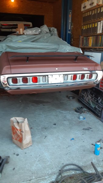

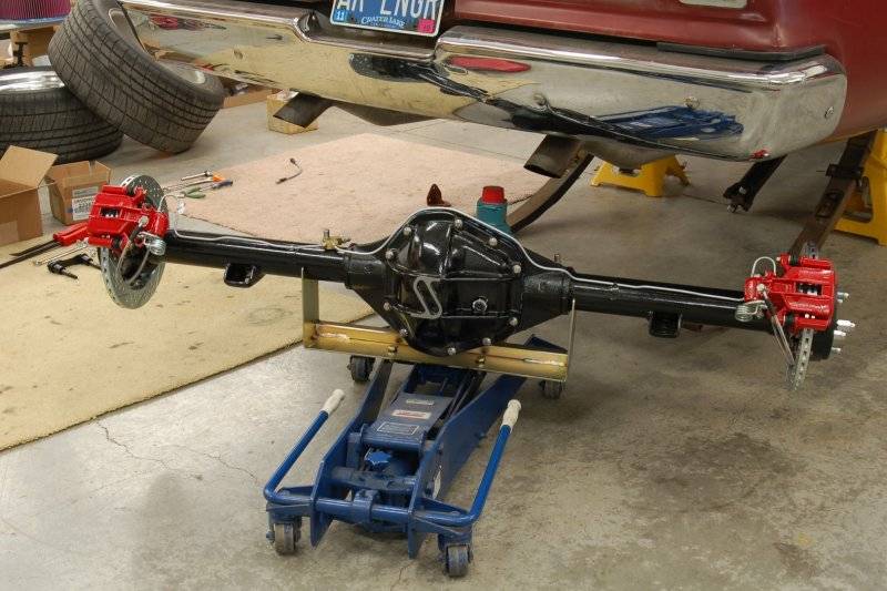

You will like the 3.55 gears,they are the perfect cruiser gears. I just ordered a new Strange Engineering Dana 60 with 3.54 gears for my 71 Charger R/T. Someone robbed the driveline out of the car decades ago. The Dana 60 is s being delivered on Tuesday.
I agree with Pete. I did the same swap a few years ago. Had an 8 3/4 2:76 and went to a dana 3:54.
What a game changer for cruising and fun.
I decided that it would be better for me to buy a brand new Strange Dana 60,instead of paying 3 to 5 grand for an original third generation B body Dana 60,and have to rebuild it before installing it in the car. The Strange Engineering Dana was 3k delivered.
