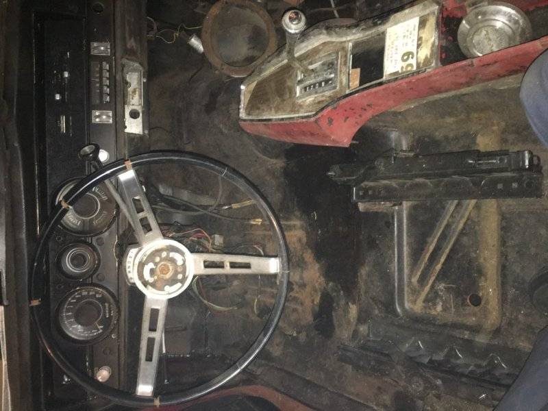

Here’s what it looks like with the console sitting down on the trans tunnel and the basically the whole front driver’s side area (I know, I’ve got my work cut out for me lol) let me know what you think and possibly a wiring schematic for the front dash rat nest of wires if anyone has one available :lowdown:

A few things you will need to download. Go to MyMopar.com there is a ton of useful stuff there. Wiring schematics, Shop manuals and many other useful items to add to your library.
Here is the page for the wiring schematics. Select your year and it will give you the schematics for all mopars that year you will have to open the zip file and find the barracuda pages. Usually just 2 an A and a B schematic. Front half and rear half of the car.
Here is the link for the Shop manuals.
