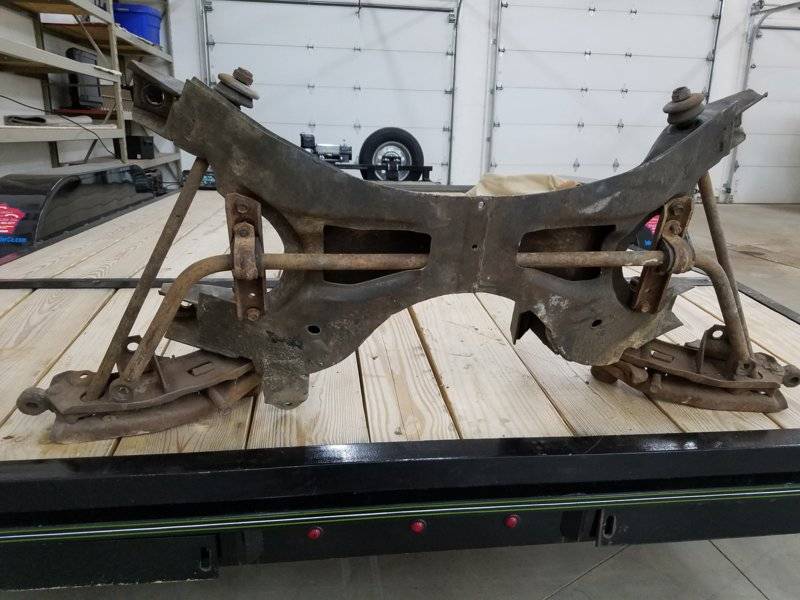

I purchased the QA1 tubular lower control arms. But Was reading saying I couldnt use the 69 sway bar. But I read that you could use a 70 E-Body sway bar. I was just looking at the setups for a 69 and 70 to compare.
1970 K-Frame
1969 Sway Bar. The only real difference I see is that the 69 is more forward But the tabs are still the same on the stock lower control arms. Doesn't make much sense that a stock sway bar wont work. But I see how the 70 runs through the k member. And its actually shorter and that may be the difference where it hooks up to the control arm.
So I guess my next and last question is will a 70 sway bar fit through the 69 K frame?

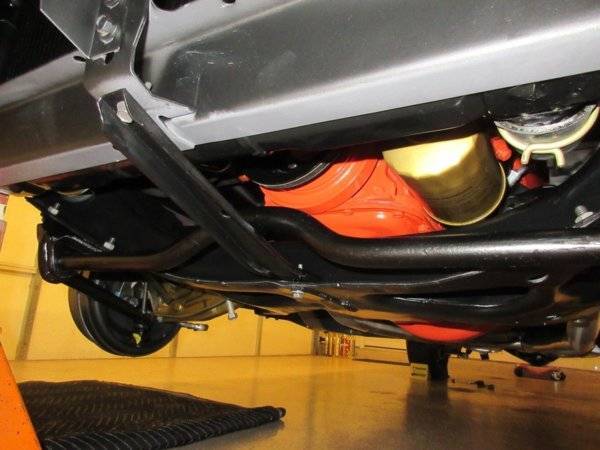

I have a 70 style mounted under the 69 K-Member and hooked up to the QA1's It works just as good. Its not really any different than the factory 69. Just moved the mounting brackets over a little.

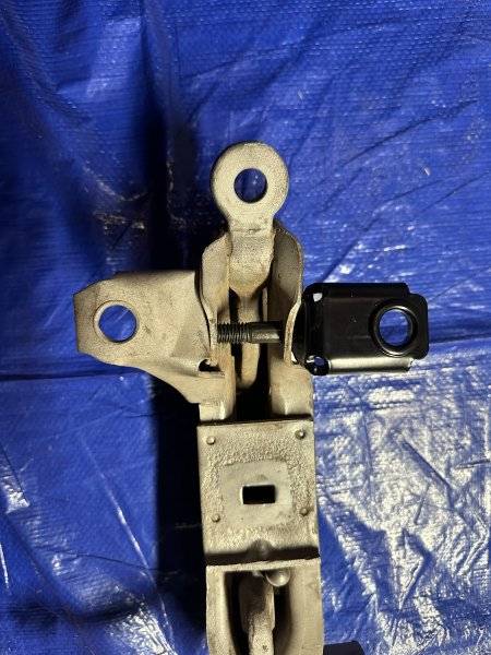

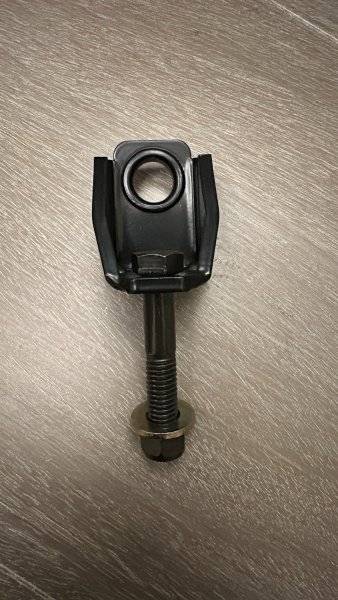

I have sway bar brackets for a 69, that you can use on QA1 LCA’s with the factory 69 sway bar.
Does someone (or you) sell these brackets? I'm pretty much sold on just going full upper and lower QA1's but would like to use the factory sway bar (using stock K frame, 71 Sebring). Do you have to weld them onto the QA1 lower or is it just a simple bolt on?
1970 K-Frame
But the tabs are still the same on the stock lower control arms. No they aren't... The 70 & up sway bar tabs are inboard probably 3.5"
1970 & up
1969 & earlier
Yep you are correct I misspoke on that. I can be wrong and was lol. Still wonder where he got those tabs or if he made them. I should have edited my post because I knew the 70 sway bar was wider than the 69.
