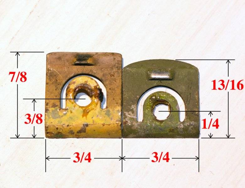

I initially emailed them the a copy of the first image below; telling them that I was looking for the yellow clip on the left, along with the year, make and model of the car, etc.. I received a reply shortly thereafter asking how many I needed, along with the usual contact information.

What a coincidence, Todd just told me yesterday morning that he has not been able to find a source for the correct sizes. He aslo told me that the correct sizes are as follows:
Vertical clips are 9/16'' height x 7/8" width and the Horizontal clips are 9/16" height and 5/8" wide. I have bought clips from RT Specialists manay times for my 67 Charger that I am restoring and I will call them. I also found a source on Ebay Grandpas.swapmeet and when I asked him for the sizes he sent me the following answer:

The clips in the photo are the original clips removed from my 67 and the measurements are correct.
Yes, I know Todd was searching once before in the past. He mentioned not finding a source, and when I mentioned having one he never asked or responded. So I assumed he was planning to do his own thing.
The clips sold at the eBay link that you've posted are definitely NOT the right clips
RT Specialties has never carried the larger yellow clips either. At least not in the past anyway.

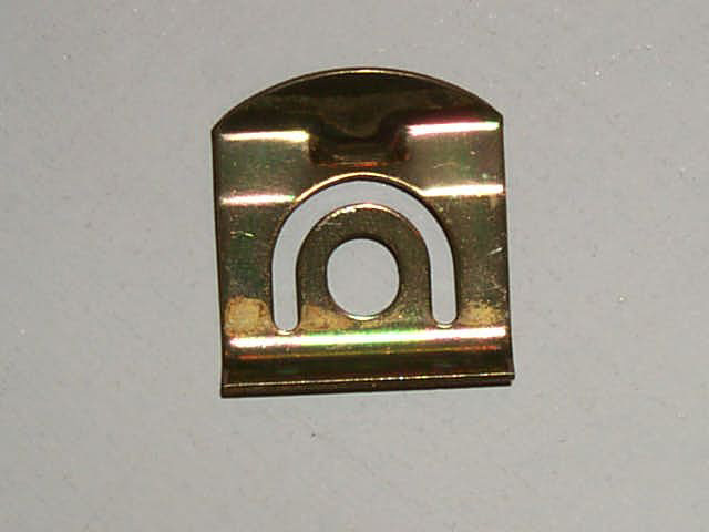

This is the rear clip sold by R/T Specialties for a 66-67 B-Body (not strickly Charger)... it's the shorter one of the two, as previously mentioned.
This one might be slightly thinner than the original, perhaps the 9/16 Todd mentioned, but it's hard to say without having one in hand to measure. Overall it appears to be correct, just a little more generic, but that's to be expected. Exterior dimensions aren't super important anyway, just a sign of quality, it's the hole and clip locations that are important.

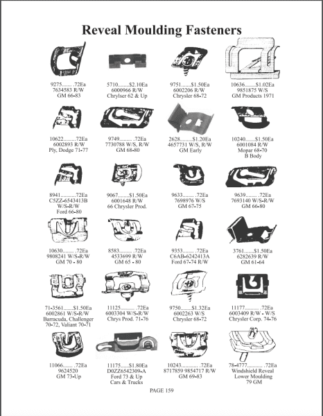

This is the note on the website that I followed up on.
They had a generic image of the 9067 clip (which I believe is the shorter one) with the following note.
Description: Reveal Moulding Fasteners, Send a sample or email a picture to [email protected] We have many sizes and types in stock. 6001648 R/W 1966 Chrysler Products
I sent them the pic, and Clip #9068 matched the OEM example I provided, even the color.

I have seen this site (Restoration Specialties) before but never looked too close at it since they did not list much for the 66-67 Chargers. Will have to take a closer look thru their catalog.
Their on-line catalog is chock full of generic hand drawings with no descriptions which makes specific identification all but impossible. The catalog is meant to illustrate the fact that they carry certain items. You still really need to contact them directly for specific parts and to be certain you are getting the right thing. Still, it is an extensive catalog of parts, so I had it bookmarked on my PC for future reference, just in case.
Here's an example page from said catalog.

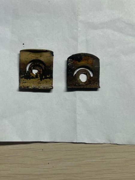

Good morning Jim, I have a few of the original clips (both sizes) that fit the 66-67 Charger rear window( see attached photo). I can mail to you today. Just don't forget me when you get the new ones made. The photo with the dimensions was obtained from another Forum member, when I was looking to find the right ones for my car. Good luck in getting them made.
