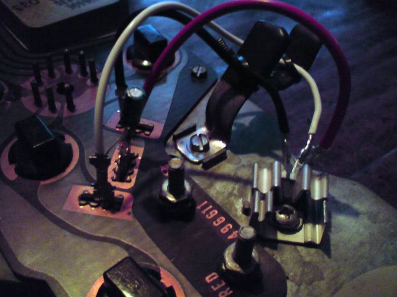

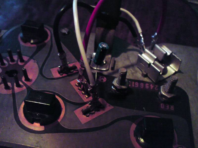

So...soldered the components to the dash, put the dash back in (which is far more easy then removing it) and...it works!! Pictures below show how I attached the compontents to the dash:

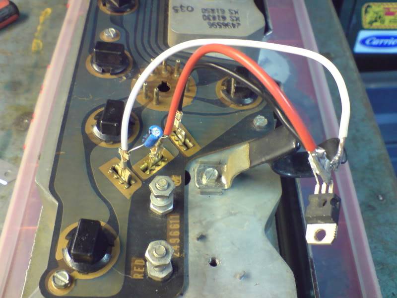

I talked to some people and it seems like there's been a shortcircuit. Take a look at the picture. There's a hole in the voltage regulator:
And yes, I used plugs to connect everything to the dash so it would be easier to remove than soldering... :grin:
Funny thing is that the first time it took me about a whole evening to figure out how to remove the dash. Now, it only took me 20 minutes (I learn every day).
I did the whole thing over again and now isolated the ends of the voltage regulator (should've done that in the first place). Haven't tried it yet on the road, but it works fine now. Keep you posted!
