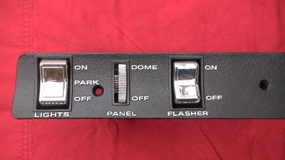

I found that for me a tooth pick worked better than a brush.
The paint pens do work very well, I just completed mine with one.
IP lettering.....
I used a fine point sharpie paint pen.... Cheap on ebay, or at an office supply store.

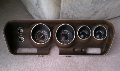

Here is some inspiration. I just got done refurbishing my 73 Roadrunner instrument cluster. I used the Krylon Silver leafing paint pen on the "chrome" areas around the gauges, and I used the Krylon Brights Flourescent Paint pen on the gauge needles. I also put in new gaskets around the blinkers, bright light indicator and a new seal around the wiper motor and light switch area plus the ones that seal off the switches.
PS, both of the paint pens are from Hobby Lobby

i restore and sell them, clean it good,dry it,use a primer,use textured black paint,last do the lettering with a sharpie white enamel pen with fine tip, and a magnifying class go slow and becarefull with the letters E and S they can drip easy do the lettering 3 times drying one day each time.
