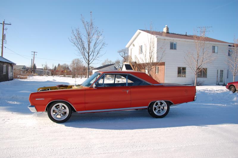

17x9" on all 4 corners
255/50R17 Nitto 555 in front
275/50R17 M&H Drag Radial in the back.
That looks great! It seems like the 50 series tires help on the tire height a little more than the 45 series. I would love to see some 17's on the 71-72's Roadrunner/Satellites... It seems that the wheel well shape on them require a bit more "fill" to make it look good.

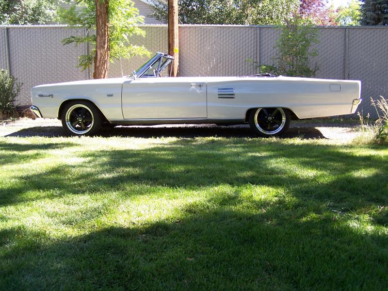

That tire combo looks much better! Since we tried to mount a 15 rallye and the curve of the wheel hit the caliper and Magnum 500's would not clear the Wilwood hub on the front brake kit. I think I am going to have to go with 17's. Just have to decide on what wheel.......and then what tire.

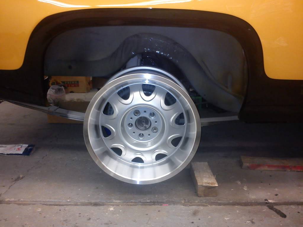

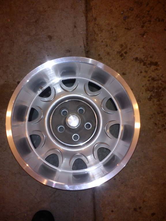

i can't find the thread so heres what I bought:
My birthday wish came true! 17x9 0"offset
on the rear of my 71 runner

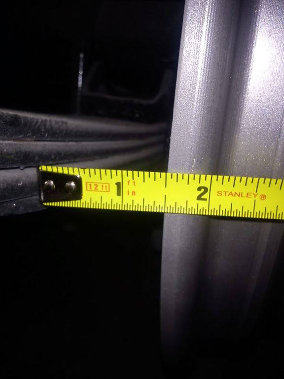

to the rear (non relocated)spring 1 1/2" clearance
to the inside lip 1 1/4" clearance
sorry no front pics as my front suspension is all out and not put together!
They look as good as they did on the net! Only wish they had the beauty ring instead of the polished lip!

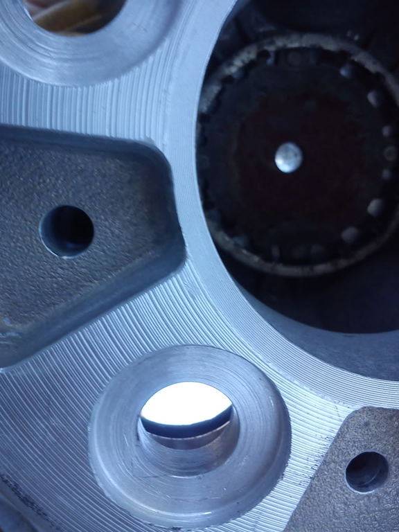

good news everybody - went and weighed them at the station today - it says 10kg or 22 lbs, take it with a grain of salt - i don't know the accuracy of it

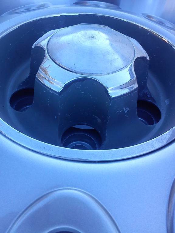

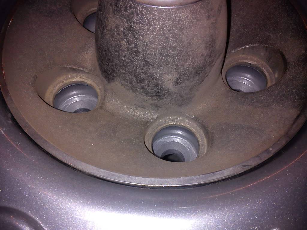

I went to the old mans house and he had a 72+ center and it fits perfect even the holes on the back match up
then went to a buddy of mines house and he had a 71 center - its a little sunk but everything still matches and lines up
he also told me of a great website that sells the centers at a decent price:
http://www.pgclassic.com/advanced_s...ubcat=1&keywords= &categories_id=5&azrefine=1
