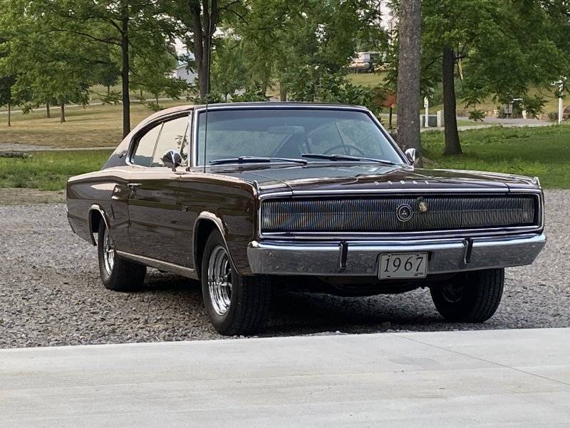

Hello I have a set of 15x7 front wheels and 15x8 rears 4 1/2 backspace. Looking for tire size suggestions front and rear. I would like a nice level appearance without much rake. just the wheel wells filled in a little more. Thanks in advance
