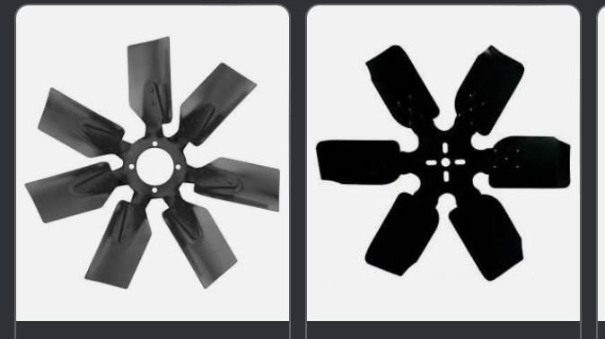

Hey Guys Im Looking For a Fan For My 383 Superbee.
I Found A 7 Blade 18’’ Fan In My Parts Bin With a ‘58’ Stamped In It.
Anyone Familiar With These And If So Does It Need To Be Used With a Clutch?
Thanks
What does the center look like? Clutch and solid mount fans don't interchange.
Looks Like The One On The Right
Left is clutch, right is solid mount.
The small center hole pilots on the spacer, just like the spacer to the water pump.
4 slotted mounting holes means aftermarket fan. Factory doesn't have slots.
Factory fans usually have a 5 digit vendor number.
And some have a seven digit part number ink stamped or stamped into each blade edge.
Broadcast sheet by chance? - Fan, spacer, radiator, hoses, etc are called out on them.
