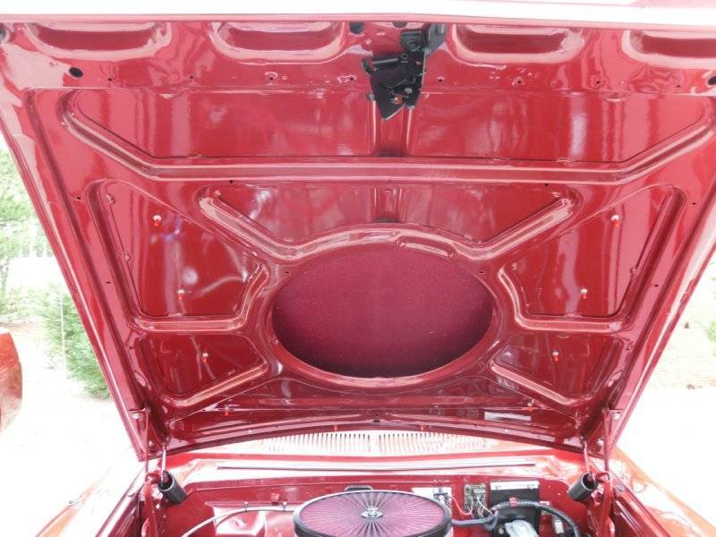

Not directly a part of this thread but thought it a good place to interject this. One good thing about the 62 Plymouth hood. That circular area in the center works perfect for a single carb on a high rise. I did this on my old 62. The 14" air cleaner cleared the hole, albeit to the passenger side a bit and forward. Cut the hole out and welded up the cut edges.

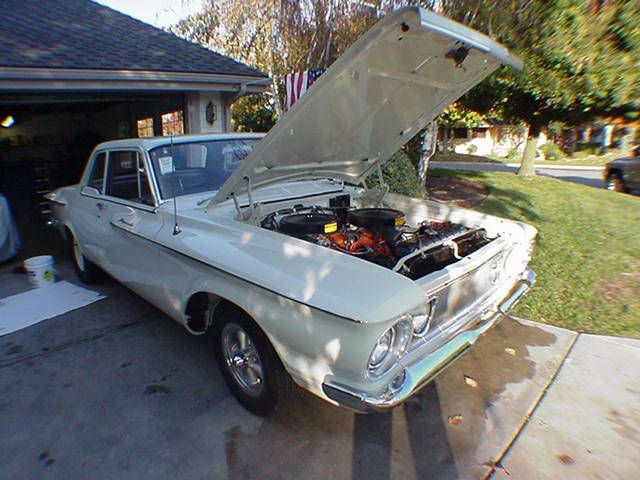

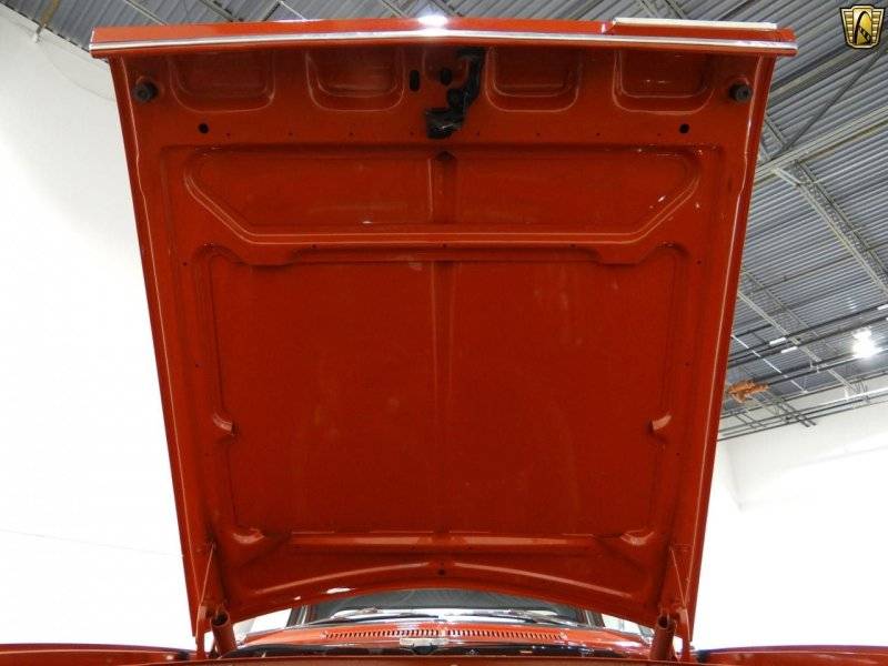

Here's my friends '62 Savoy Max Wedge engine compartment. Correct to the upmost.
The hood picture I don't believe is of his actual car, but his car has had the same hood with the cut outs as y'all see in the picture from the factory. He acquired the car from one of his best friends here in Brooklyn way back in '69 IIRC.
