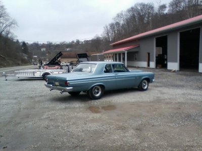

Threewood, can you post a side pic of your 62? I've got same springs I'm about to put under my 62.

I have the 456/457 springs on both my 62 Belvedere and 69 GTX. 3400lb rating for both. My 62 is about 1.5" raked forward. To be determined on the X as it doesn't have a motor yet.
