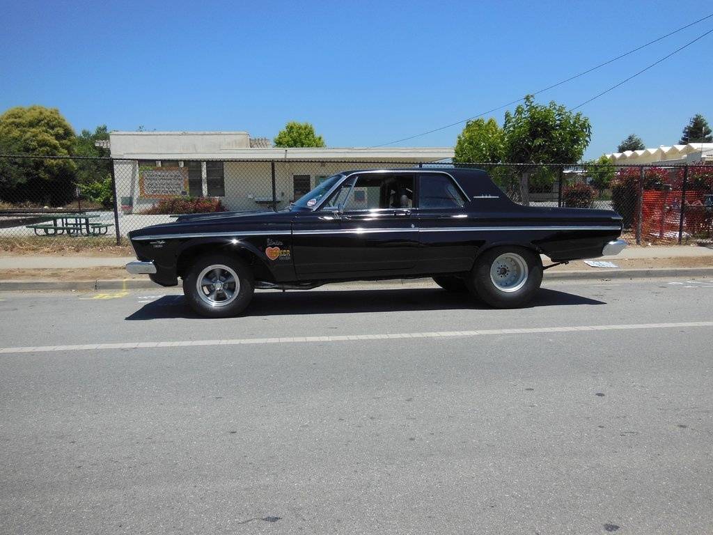

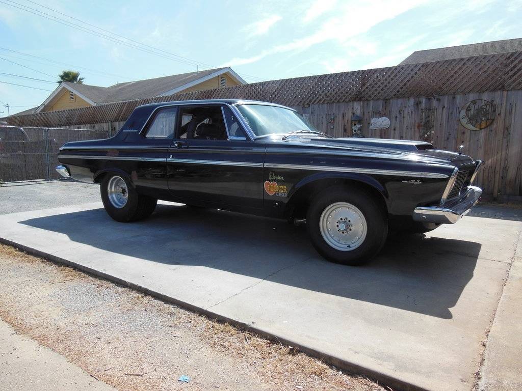

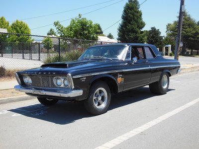

well..we got it done today..the lady at the dmv's husband who did my VIN inspection works on MG's..i knew right there all was going to be well...on time and on target I now have my plates...DONE!.the car rolled into my driveway from the hauler with wheelie bars but,,I thought that even the most leniat inspector would be eyeballin those closely!lol...so I took those off...
did not go very far..had a brake issue which is now fixed..1 last thing is the steering coupler has a little slop...before I put the break in miles on the new 4.56 gears...but its running good...thanks for all the input...I told her that the vin plate spot welded on the door jamb was it,,then she wanted hood up.. and after looking at the casting date on the crossram it was done...150.00 total transfer fee including plates..more pics later ..
