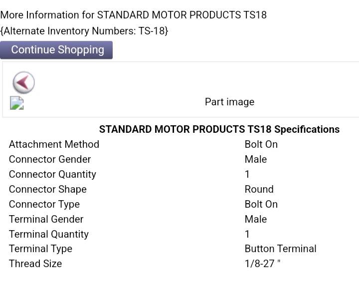

Looked up '65 Dodge with guage, with 426 ci
Came up with Standard TS-18
Wait for others to chime in. I'm having a real bad internet connection.
That one doesn't fit. My wiring harness temperature lead is for a sensor with the threaded stud. The TS-18 is for a clip on terminal. I guess the 1T1010 shown would work, But it states 13mm. Nothing on a 65 was ever metric.
