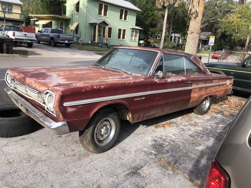

My plan with this ratty but solid 1966 Belvedere II hardtop I just bought is to build it to look like a NASCAR stock car from that era. I will mostly keep the external patina, with some improvement. I intend to enlarge the wheel openings by cutting the fenders and quarters similar what they did back in the day,
and using a porta power as necessary in the rear to facilitate the use of larger wheels, possibly 15x10. I know it is isn't a Dodge, but I am going to try to mimic the paint scheme of the Cotton Owens #6 driven by Charlie Glotzbach.

I probably wouldn't cut those quarters.. They look to be in decent shape. The rear wheel house is welded to the quarter skin. I doubt you would achieve what you are looking for cutting them up.
I know what you are saying, I kind of hate cutting a car like this too. But it will definitely do what I want to do. I will separate wheel house from quarter skin, and porta power skin out to give fender bulge.

So now that I have had time to closely inspect my Belvedere II, I tend to agree with some of the comments. I think it is too solid a car to cut up. I have found absolutely no filler in the bodywork. I think I will just fit the biggest wheels and tires I can fit without cutting it.
If you work with the wheel backspace you may be amazed at how large a tire might fit.
